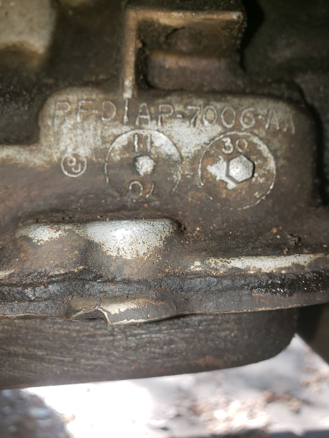

17 bolts on the pan.
Also, here is what I think is the casting number.

D?AP-7006-AA is the casting number for the transmission case (Ford basic part number for the case is 7005). Casting numbers are foundry marks, cannot be cross referenced to Ford part numbers.
The C6 trans ID tag was bolted to the servo cover on the left side of the case, but by now, most of these tags are missing.
Both the 351W and the C6 are probably from a car, LTD or Mercury Marquis for examples. 351W introduced in 1969 Ford/Merc Passenger Cars, wasn't available in F150/350 & Bronco until 1981.

The 351W may be from the 1980's/90's, but the trans isn't.
The casting number prefix on the trans case is from the 1970's. D = decade = 1970's, 2nd digit is the year, 3rd digit is the vehicle it's for, 4th digit P is A/T related.
The 2nd digit of the prefix is hard to make out, but if it's D1AP-7006-AA = 1971. 3rd digit A = Galaxie/LTD/Mercury Marquis.
There is no Ford kickdown rod that will work, plus since the trans is probably from a car, the manual control selector lever that the rod attaches to...is different than a truck.
You'll have to use a "universal fitz-all" Lokar cable.
