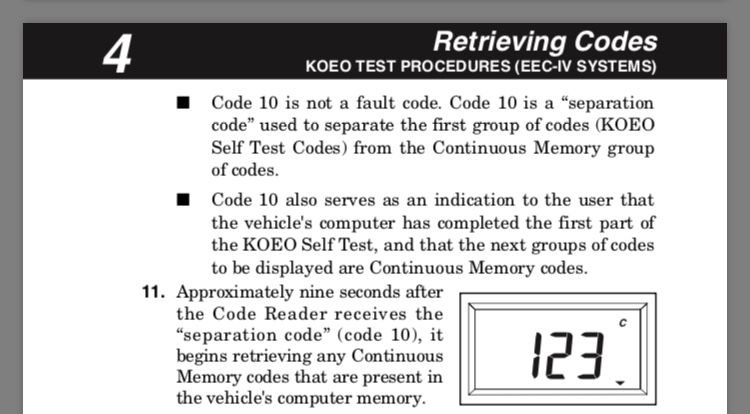

From the Innova 3145 owners manual:
Code 10 is the separator code between active and stored codes.

Cylinder balance test is only available on engines with sequential injection, which these trucks didn't have in 87. The balance test (if available) is started manually with a stab of the throttle after the KOER test is complete.

Sorry for the delay, yes I did finally run another test. The 10bis still there. Only came up once and I think you are right on it being a separator code

Correction: They are right on it being a separator code
