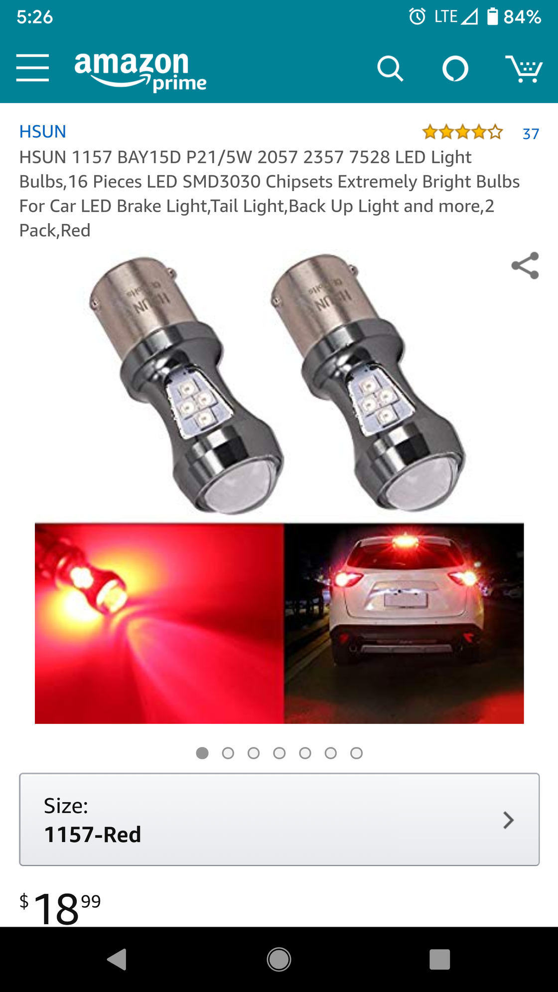

LED tech has become pretty Rock solid. Just remember they are diodes and only allow current to flow in one direction. So if they don't come on, flip them around.
I used these in red for my tail/brake lights. Then their white offerings in the turn signals and backup lights. Very bright. Plug and play fit fine.
LED' have the added bonus of drawing less power. So if you have a stock alternator that frees up less draw for lights and more draw for other goodies.
