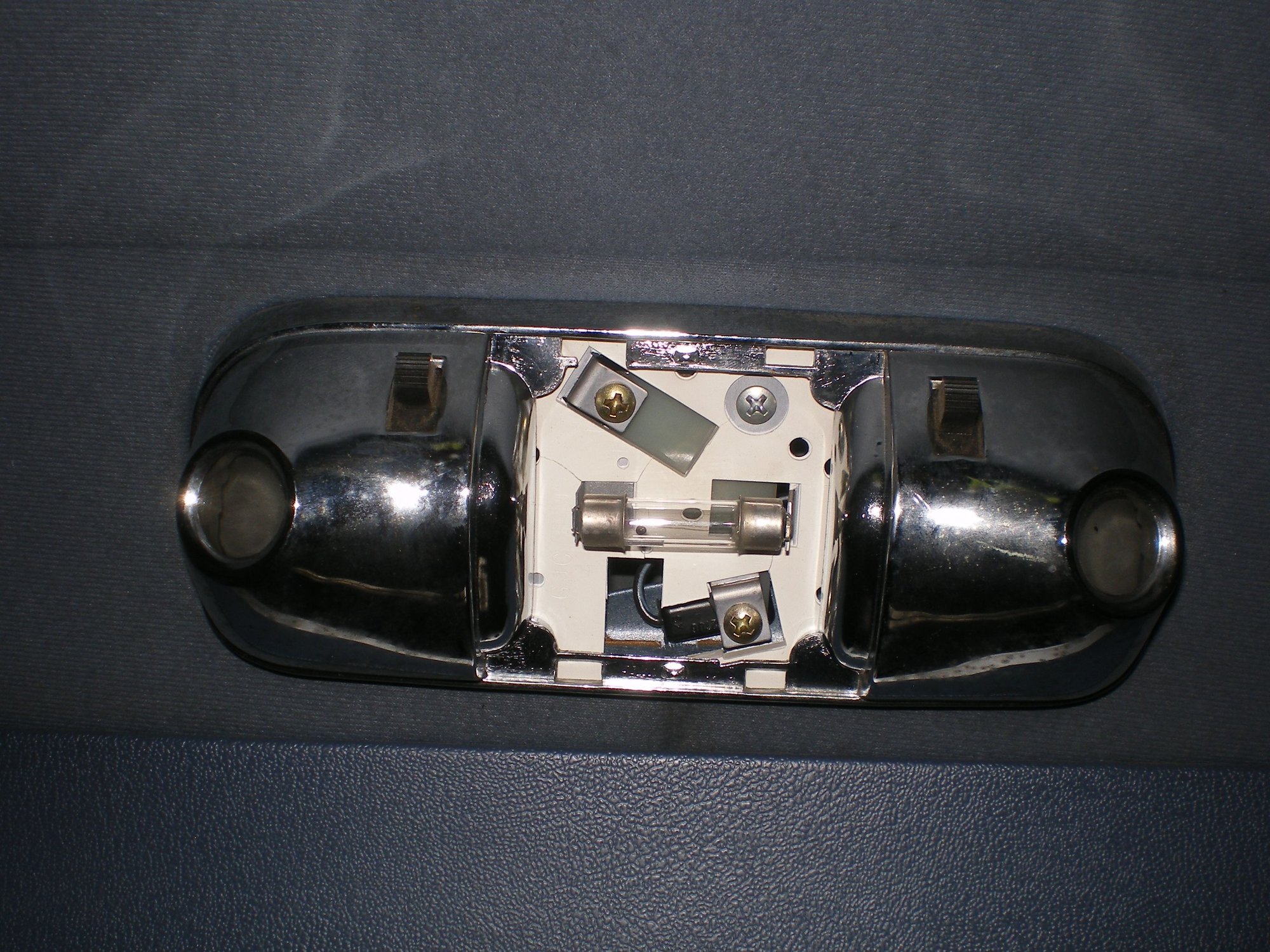

Originally Posted by Luke76
Your dome light housing must be quite different. All the ones I have seen take a 194 style/wedge base bulb, not a festoon bulb.
Mine is the same as the OP has, see his photo in post 3 with the LED mod...
A stock bulb is a Eiko 211-2
Eiko 40480 - 211-2 Miniature Automotive Light Bulb - Incandescent Bulbs - Amazon.com Eiko 40480 - 211-2 Miniature Automotive Light Bulb - Incandescent Bulbs - Amazon.com
Jim
Old Nov 1, 2014 | 02:49 PM
Luke76's Avatar
Luke76
Joined: Jan 2012
Posts: 582
From: Corvallis, OR
Actually, I am the original poster and no that is not the same bulb that my housing takes.
But I see now that some housings apparently do use the festoon bulb, because that is what yours has. Thanks for posting that.
