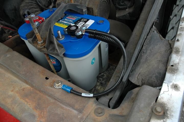

Keep in mind the ground path goes through the radiator support, bolted to frame, wiring through to the firewall, solenoid, the floor switch, back out to the lights, etc. Poor ground paths, loose or missing straps and stuff starts getting goofy. They search for a ground through unlit bulb filaments, things like that. If any of the starting and battery ground straps or cables are original or even just kinda old they should be replaced. There might be a strap from a starter bolt to the frame, make sure this is clean and tight down to shiny bare metal. Coat it with something, vaseline, NO-OX, etc.

I always go battery to frame frame to core support then frame to engine and then engine to fire wall, and if your truck doesn't have them star washer's on all ground connection's especially the one's that ground your headlight's and turn and marker light on the core support
