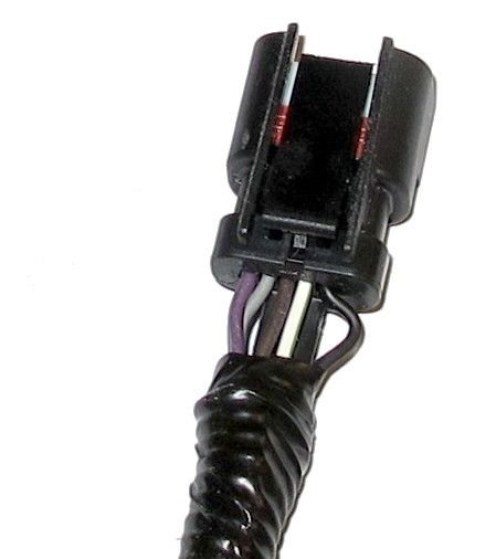

Care to share a bit about your truck and how you figured out the wiring? I've bought a harness and camera, but couldn't find the wiring information necessary to connect the camera. It seems that Ford changes the wiring colors, and perhaps even the pin locations from time-to-time. I put the project on hold until I could take apart the tailgate and scope out the wires.

Thanks, I had seen that website before but couldn't figure out the wiring from that site as the captions didn't seem to go with the images, which were mostly from 2008/9 model year screenshots.
After a bit more searching I think I've figured out the wiring that applies to 2013-2016 super duty model years using tailgate harness - FC3Z-14A412-A
From the powerstroke forum, for the camera end of the wiring harness.
Pin 1 - VT-GY - 12vdc
Pin 3 - GY-VT - Control Mod.
Pin 3 - BN-VT - Video -
Pin 4 - WH-GN - Video +
Pin 5 - BLK - ground
Pin 6 - not used
From the dieselstop forum I also found this, which is almost the same, and is the same if you go by wire colors.
Pin 1 Violet/Grey +12V
Pin 2 Grey/Violet ????
Pin 3 Brown/Violet Video -
Pin 4 White/Green Video +
Pin 5 Black (not used)
Pin 6 Black -12V (grd)
Here's the camera end of the cable and connector that I'll cut off. As you can see, the harness has 5 wires out the back, but it is a six pin connector. The colors match the first pin-out described above. After I've given these pin-outs a try, I'll update this post with my findings.
