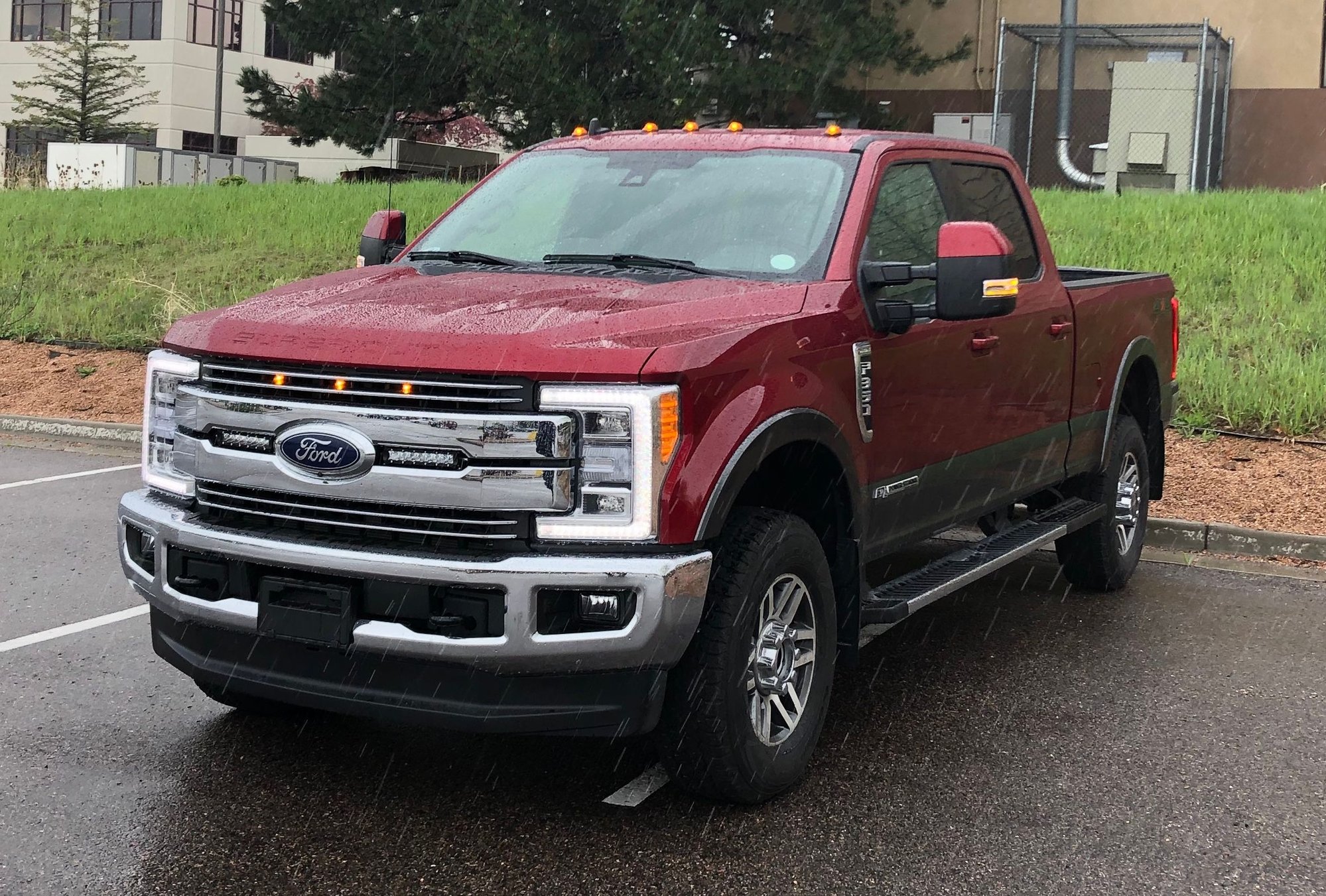

Or save $500+ and get the Rough Country kit. It fits great and the LEDs throw a ton of light. If you're looking for offroad type lights (not used in traffic), then I'd start here with these grille mounted lights. Then, if that's still not enough, add another light bar as shown above.
I have the RC grille lights and they're wired into an Upfitter switch. Really like these for dark roads.
If you're looking for on-road lights (to be used in traffic), then you're sort of stuck. Brighter bulbs generally (not always) just look brighter to oncoming traffic and don't end up throwing a lot more light for the driver. You really only improve the headlights for driving when you replace the headlamp fixture.

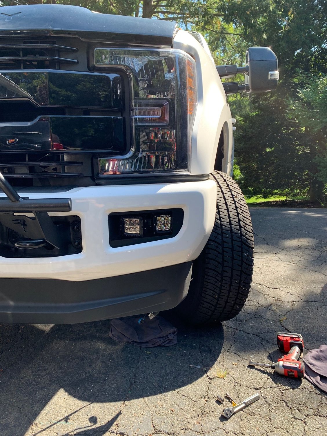

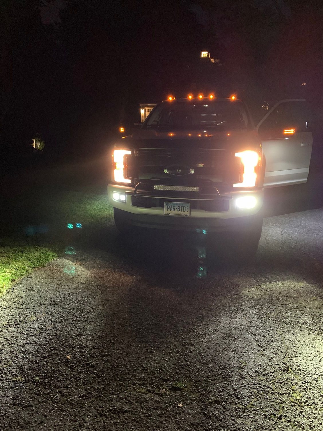

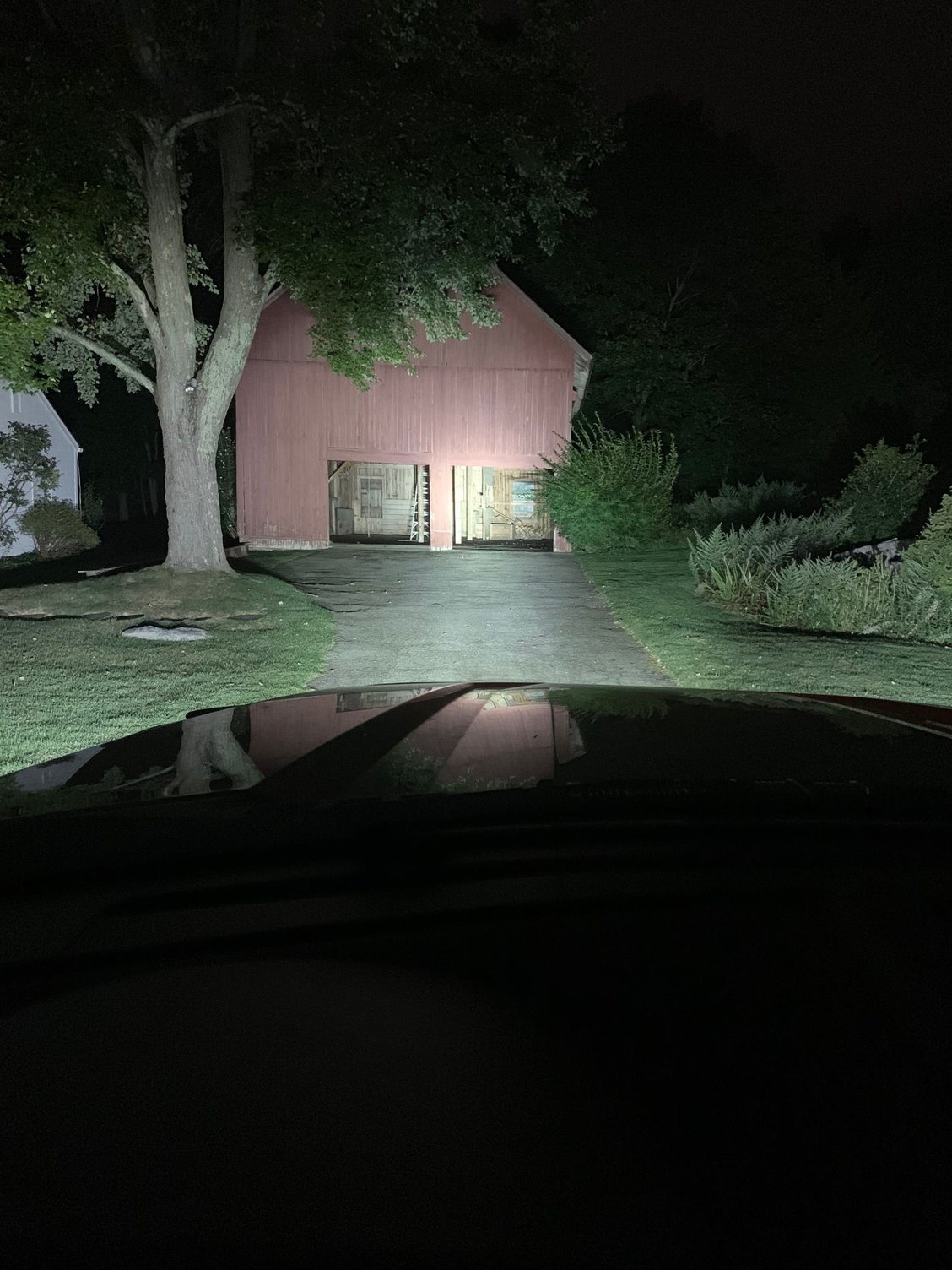

I did the light bar and dual cubes:​​​​​​​

67L48 - thanks for the photo. Your truck looks great. I really like the look of those light bars - they look like they belong there. I like accessories but don’t want to take away from the looks of my “very pretty truck” as wifey describes it.

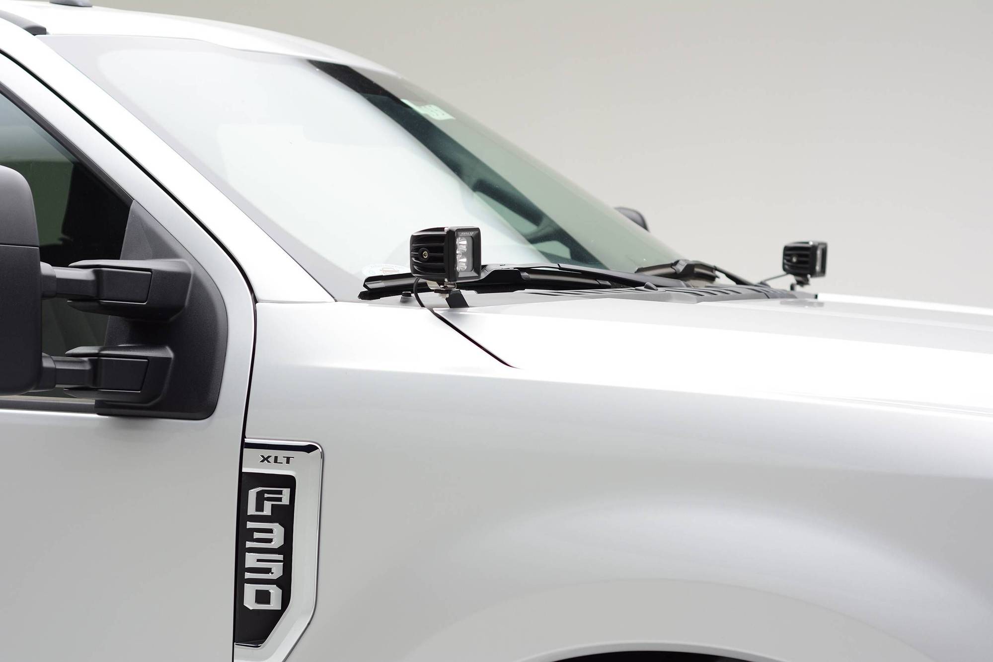

One way to do this is with hood hinge mounts and cube lights. It sort of defeats one of your other principles of a more integrated look ... as the hinge-mounted lights kind of stick out. But, it's one of the best ways to do what you want: lights that can be directed to the sides.

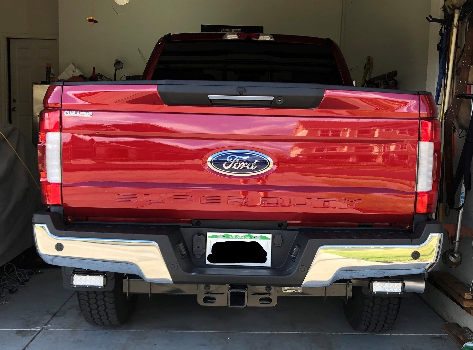

Super easy. I grabbed some cheap 6" flood lights off of amazon. Work great. If I have to replace them every year for the next 20 years, they'll still be more affordable than the quality brands. I have them tied to an Upfitter because I definitely don't want them to come on every time I'm in reverse ... way too bright for that.

I bought what look like pretty much the same lights from Amazon. Bolted them to the underside of my running boards with factory nuts and plugged them into the wiring harness that resides alongside the frame. Nice puddle lights when I open the doors. This was on my 2017. Kept the lights when I traded but have yet to mount them to my 2019.

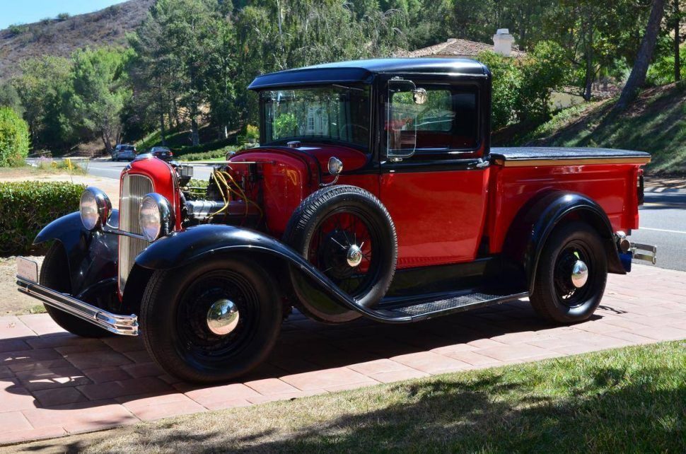

67 - Thanks for the reply. The hood hinge mounted lights are truly a blast from the past. They were on our old pickup truck and back then were called cowl lights. They mounted in that same area. The truck was a 1931 Ford Model A. I have attached a photo that shows a pickup with cowl lights. I do not know how to enlarge a spot on the photo. The truck in the photo was not mine, just grabbed from the internet.
Zoom in to see the Cowl lights.
