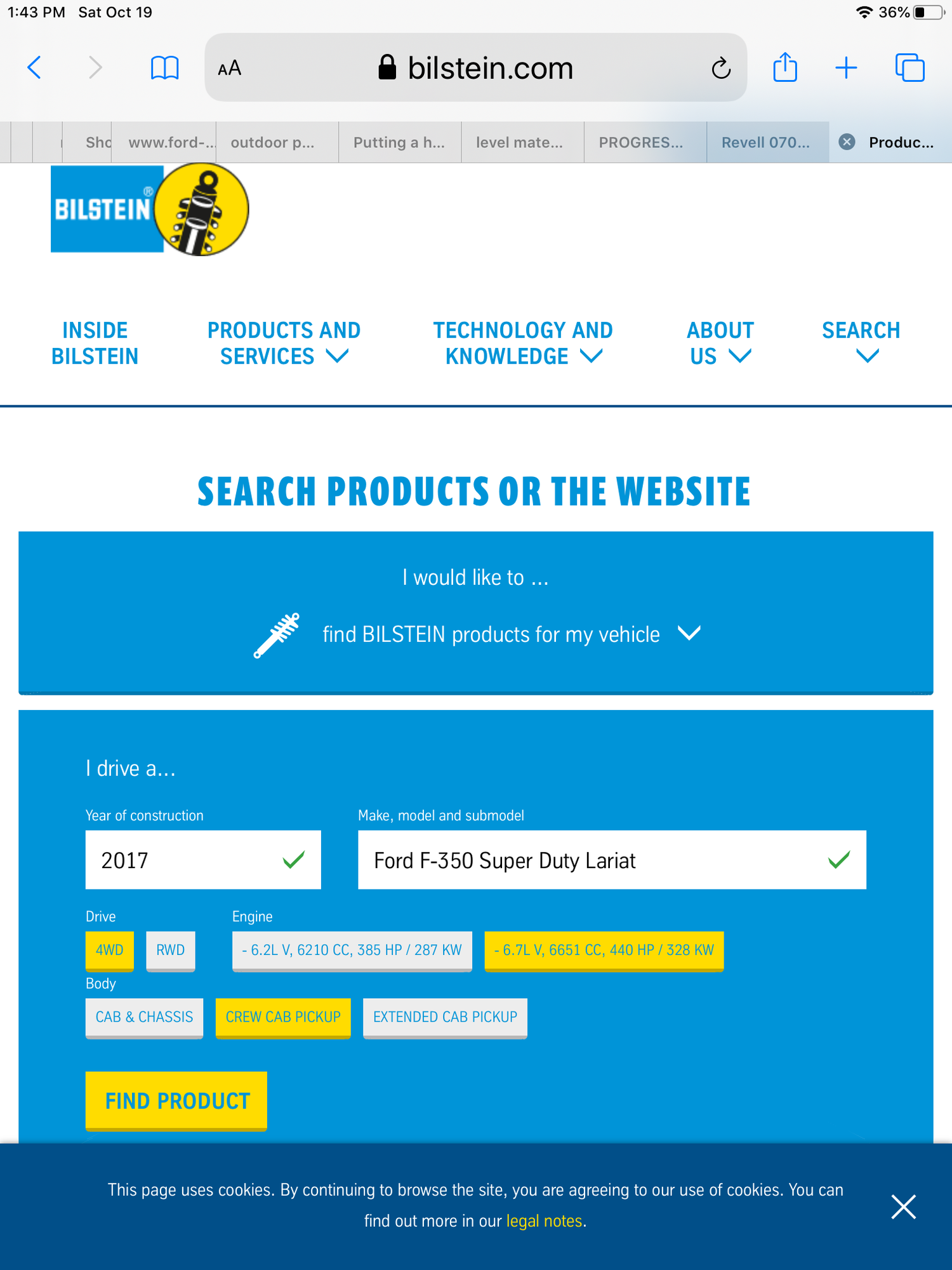

Shocks are a tired subject on this forum so my apologies but I am wondering if there has been any change to the suspension components with the 2020's. My guess is no but since I have ordered an F350 CCLB with a 12,400 GVWR I started wondering what they did to get the 900 more pounds over the previous model. Maybe just a paper change. I was thinking about ordering a new set of shocks for the truck but maybe I need to hold off.
I did look for Bilstein 4600 but for some odd reason the website only lists them for the 1898 thru 1997 F350. WTH????? Anyone know if Bilstein makes a 4600 for the Ford SD's? Anyone tried them?
I did change the shocks on my KR to the Ranch 9000XL's about a year and a half and 20K miles ago. I kept the original shocks and have thought about putting them back on and using the XL's on the new truck, if they will fit. I would only do that if I wind up trading. If I sell the truck myself I will leave them on. Still debating that issue.
2017 - 2019 F250 F350
Bilstein 4600
Front 24-274937
Rear 24-274944
Bilstein 5100
Front 24-274951 2" - 2-1/2"
Rear 24-274968 0" - 1"

Thanks for the Bilstein info. There must have been a problem with their website or something. I could not get past the year.
