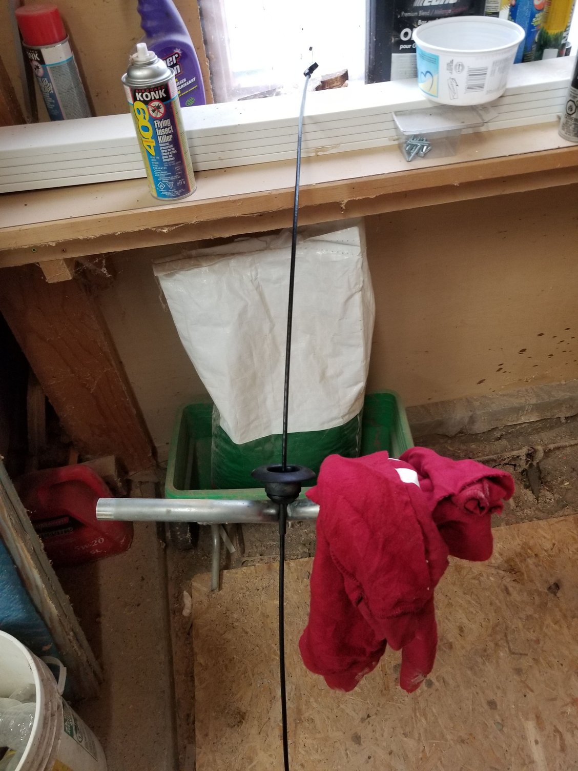

What does this cable look like?

Old Oct 22, 2019 | 04:58 PM

Don't reckon the one from my donor truck would be a match either. looks like yours is longer than stretch armstrong and runs through the firewall? Mine does neither of those things. It's about 43" long, coil on one end, crook on the other. You could try dripping a penetrating fluid on it. Hang up vertically, and I'd probably use a plastic bottle with a hole drilled in the lid and a rope stuffed down to the bottom of it, then hung down and wrapped around the end of the cable so it wicks up the rope and onto the cable and down into said cable. I'd probably just use diesel as well, but I have it on hand and it's quite a bit cheaper than my favorite libation.
