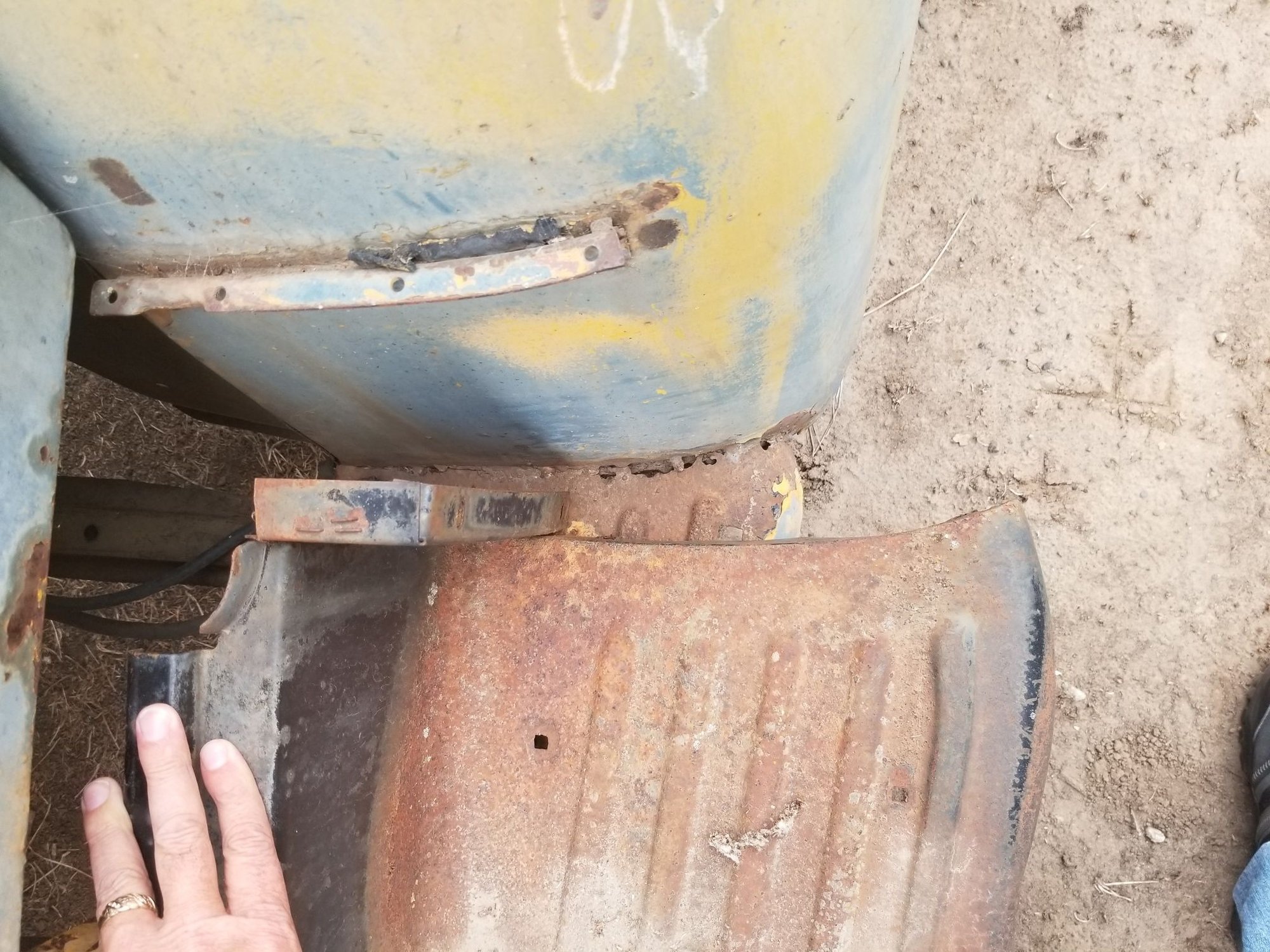

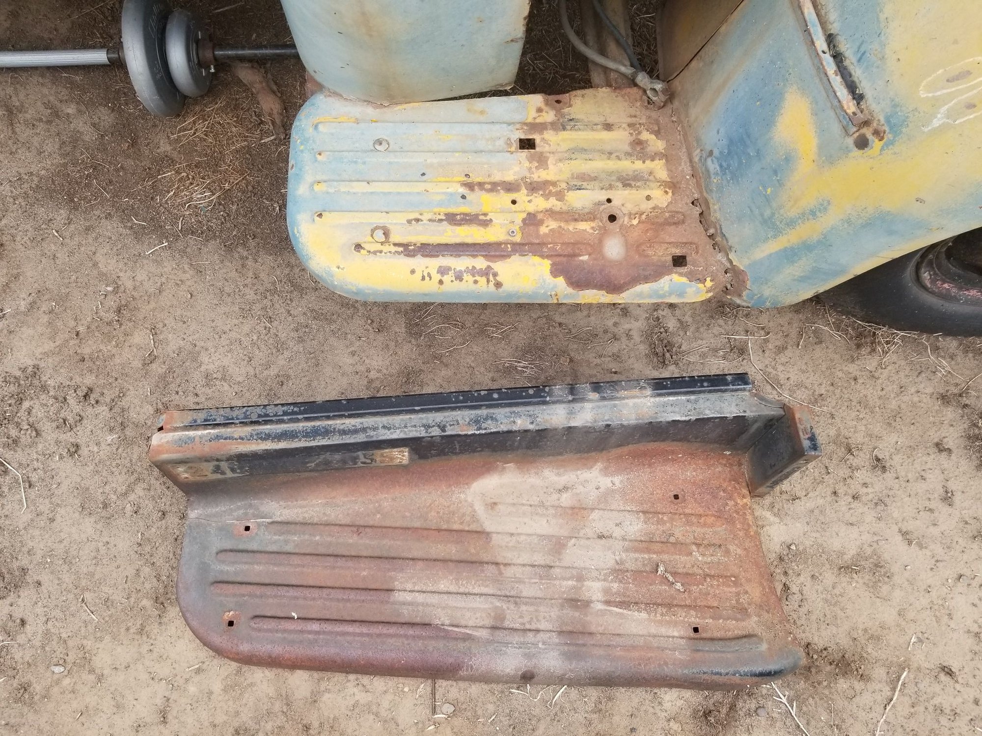

Has anyone compared the dimensions and forms of the front third of a F-1 or F-2 running board to those of a COE running board? Since the small truck boards are easier to come by than the COE's, I was thinking I could make a good COE running board out of one, no?

Bob what i was looking at was F5 and F6 running boards.
They have the round end for stort style and the difference on fender side can be adjusted with a cut between the curve and the beads.

The F6 runningboards are really narrow compared to the COE boards. All of the conventional boards have a pretty good taper to them that will make them difficult to modify. You will probably have better luck with F8 boards, as they are about the same width as the COE boards, and have a similar fender mating edge. It will still take some serious fab work to pull it off, though.
F6 running board
F8 running board

I think I remember member 50COE had f1 running boards backwards on his at one point and the rear contour actually matched up very well with the COE fenders. Let me see if I can find the picture.

Here is the picture I was talking about.
