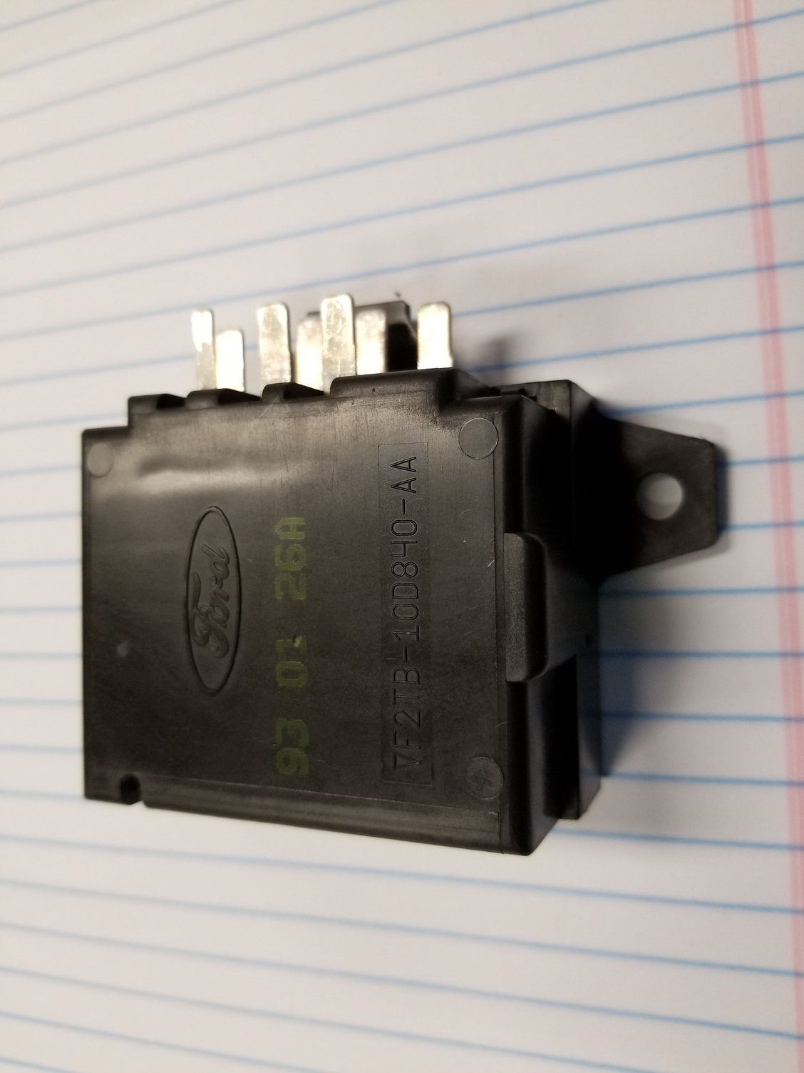

Here is what the chime looks like.

So strange it has more than just two connector blades on it????? Talking about making something way more complicated than is needed.
Is it a good idea to disconnect the battery first?
Old Oct 21, 2019 | 05:57 AM
LSCRX's Avatar
LSCRX
Joined: Apr 2015
Posts: 338
The different blades are for the different chime triggers, there's a common ground, and then a blade for headlights, a blade for your seatbelt, etc. If you find a buzzer they have less blades (but connect to the same harness) because they aren't triggered if you leave your lights on. The "lights on" warning was the main reason I swapped my buzzer for a chime in my 1995 XL.
