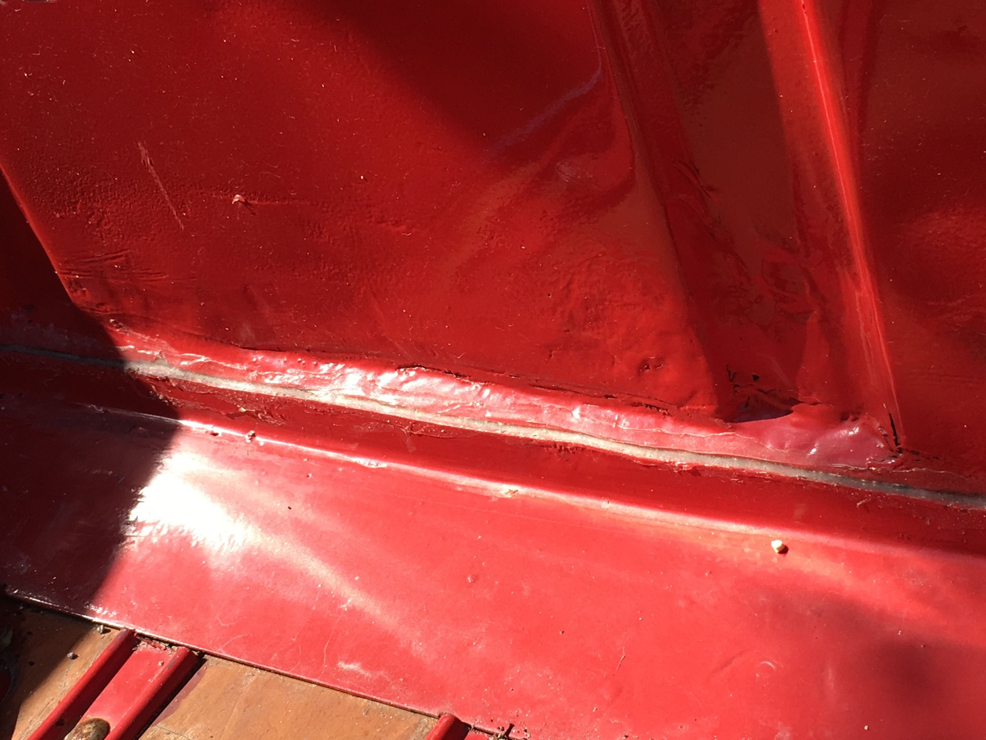

In addition to the torque box being missing, the bed to cab juncture is pretty much a rusty mess.

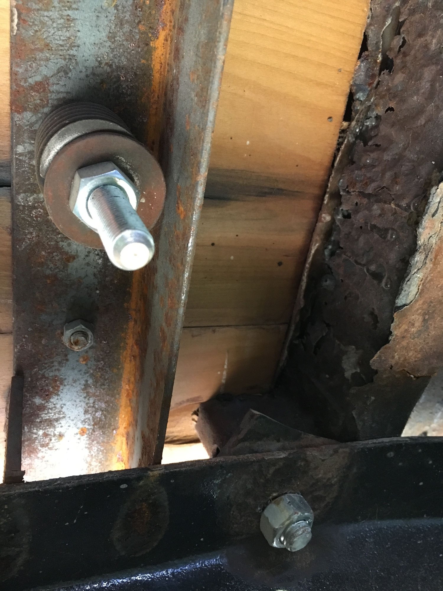

The newer cross brace is tack welded to the frame.
Here you can see that the front remnant of the original torque box, and the new cross brace rest on the frame. I'm hoping this would indicate that at least the body is resting on the frame and probably maybe won't settle too much?
I'm assuming the torque box was a rusty mess and got cut out when the wood floor was put in.
Note the crack entirely across the back of the cab.

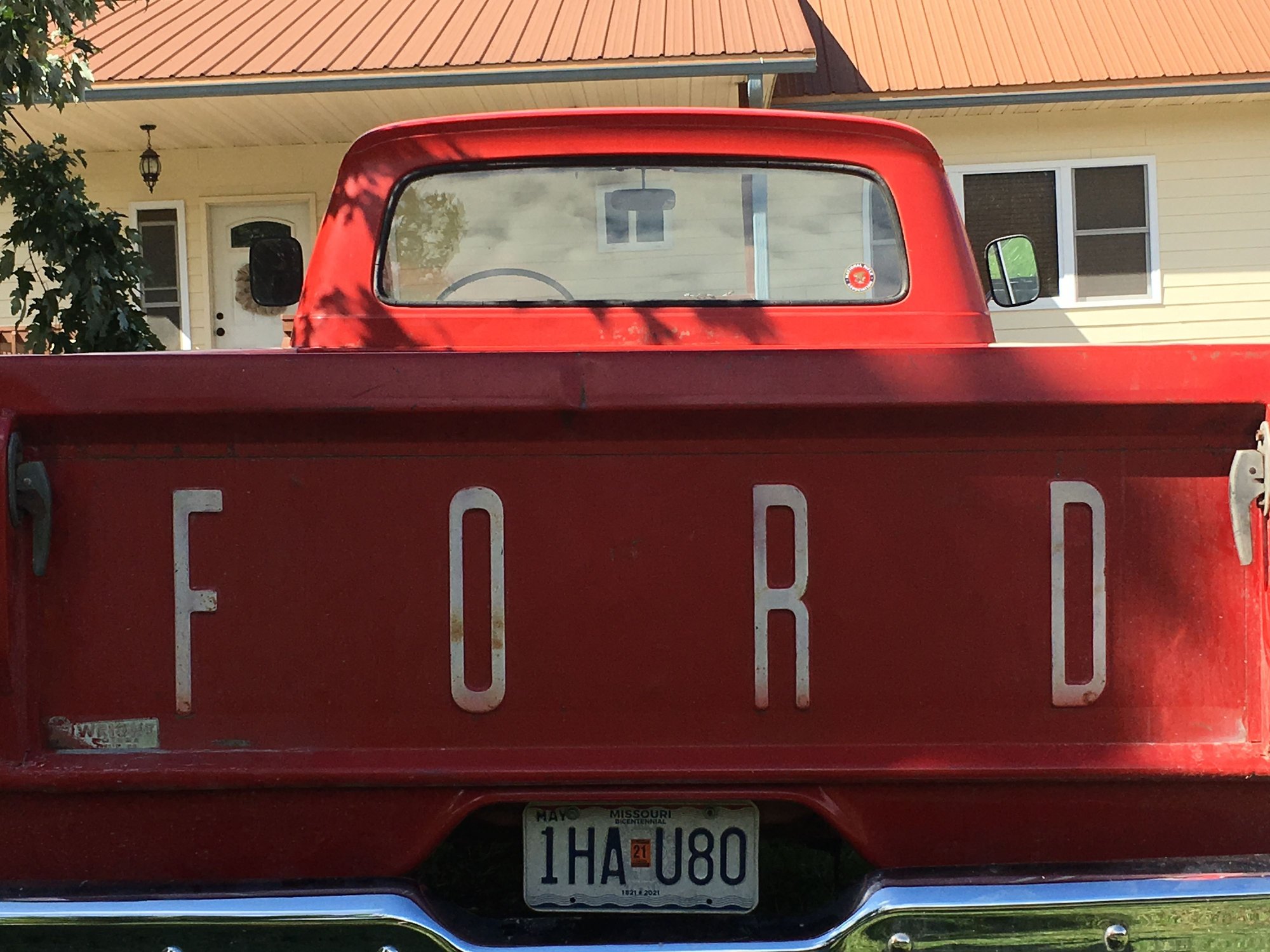

Wood bed. You can see that the remaining bed bottom is slightly sloped inward. I don't think this was the case from the factory. There's a lot of bondo in this bed, from the previous cosmetic "restoration."
It's tough to see, but the left bed rail is slightly lower than the right, making the tailgate slope down to the left just a bit.
