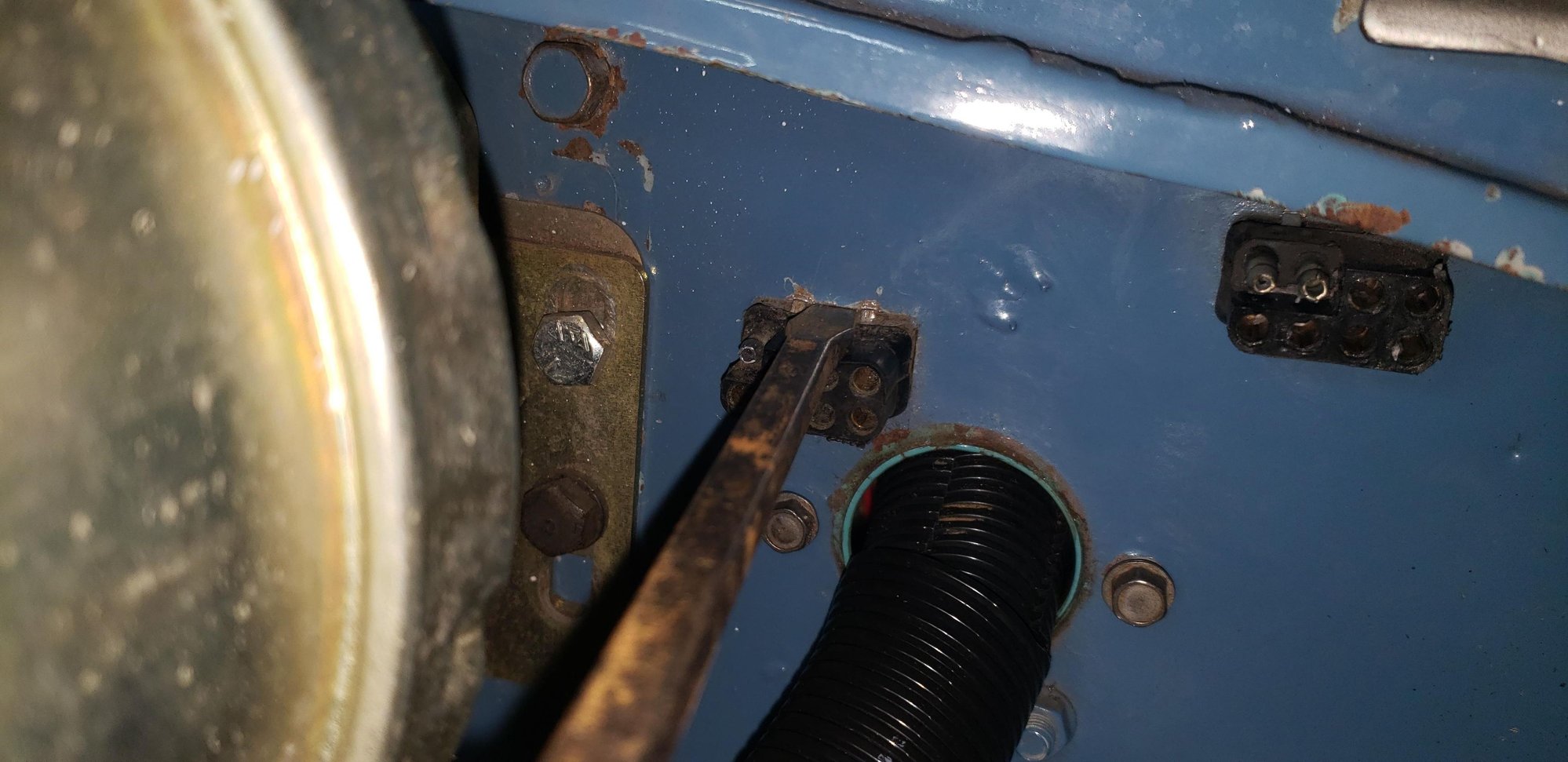

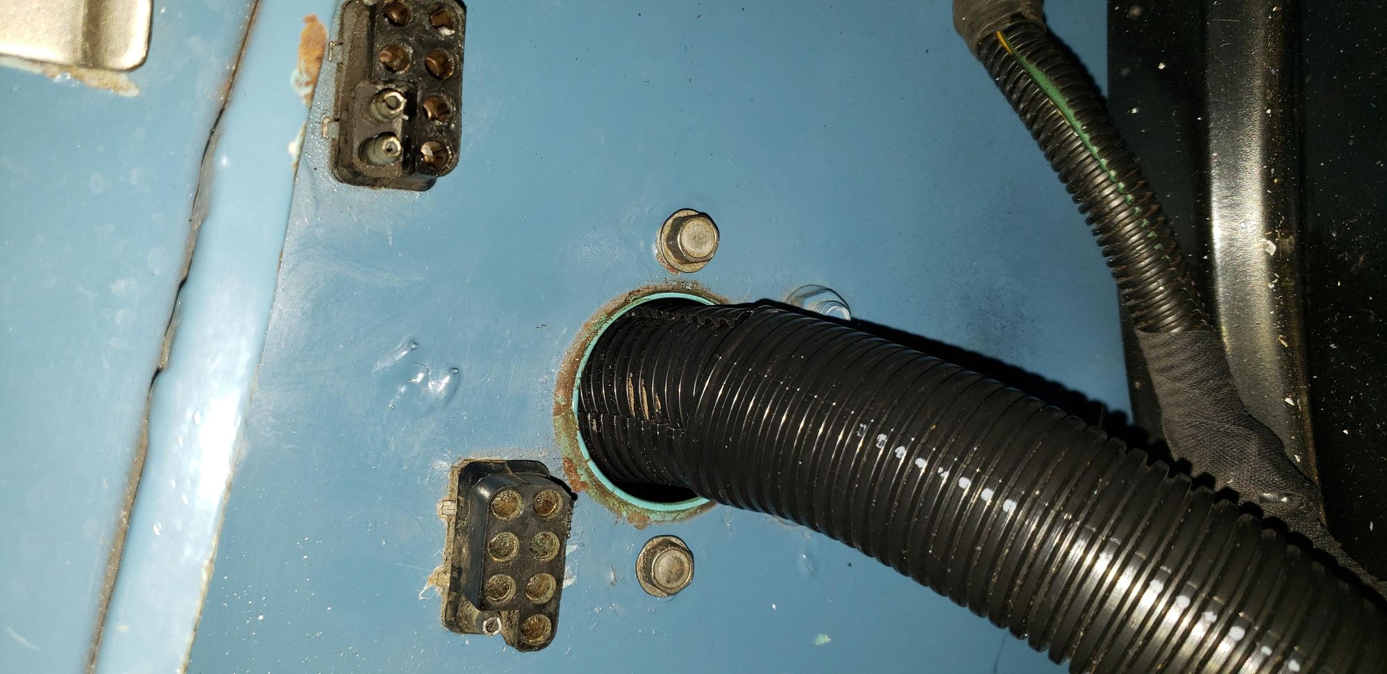

A couple of pics for those whom may need to know. The metal clip wraps completely around the connector plug. I mention this for I thought the clip may push to the side or something. Would have ended bustin something up.
Thanks again, Hammy
Used this screw driver to just push in between the two small clips, third hand pulled in and down on the driver side.
Metal clip seems to be one piece, wrapped around the connector. Must remove with connector.
