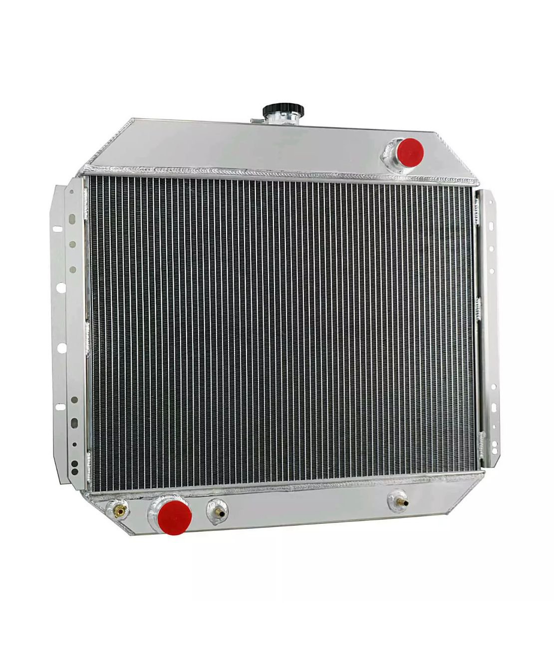

When I needed a rad back in June, after reading countless threads and studying up on them I decided on a Champion but couldn’t find one anywhere. I ended up ordering a 3 row aluminum rad from D2 performance off eBay and it has been great so far. No leaks, no overheating, driving or in traffic. I have a ‘77 F250 with AC and Trans cooling. I feel like they had a rad for a lot of different options. In June it was $160. I did buy an upgraded Stant 13 psi cap for it though. Looked similar to this...
