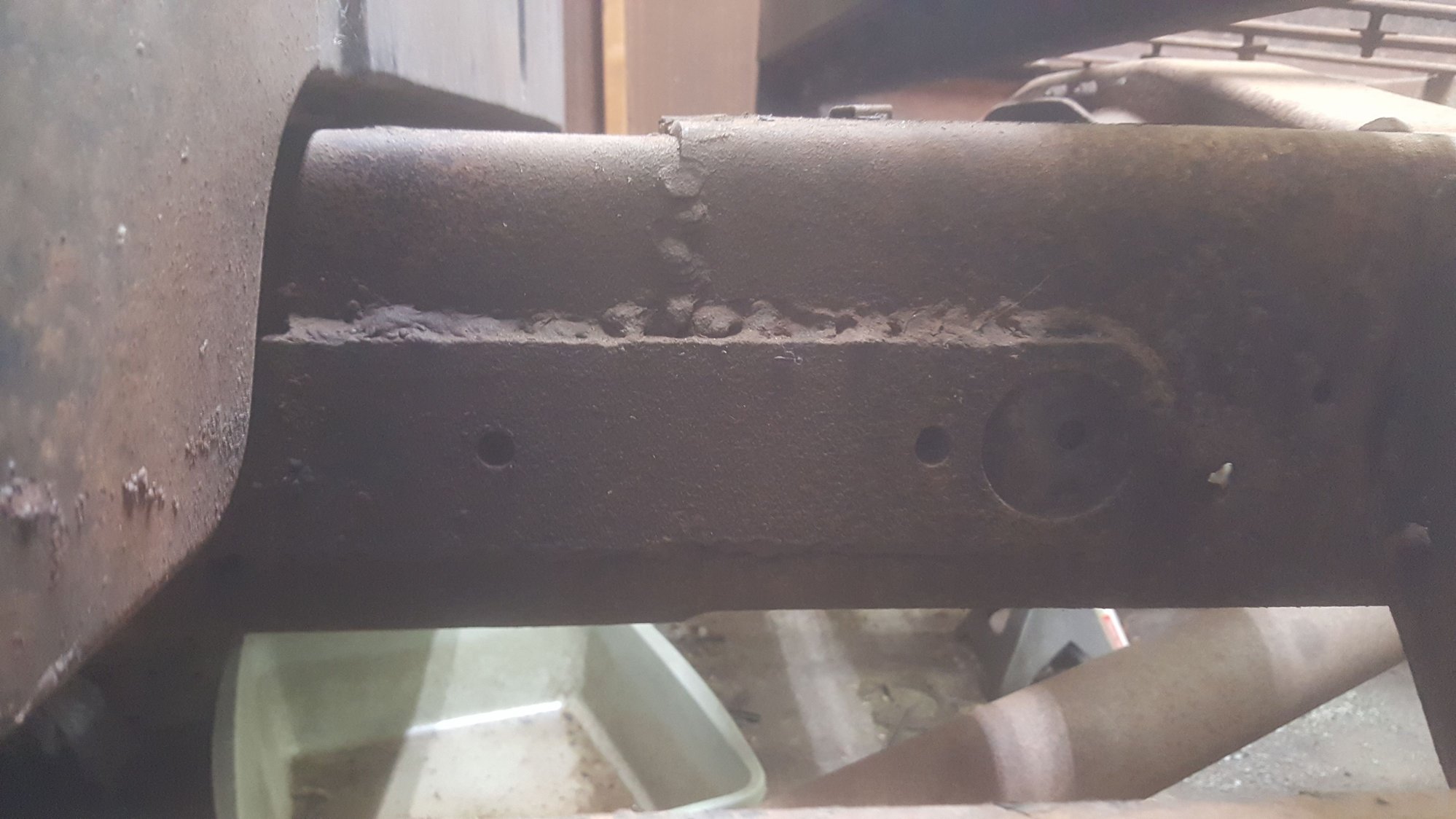

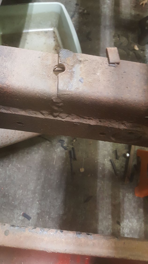

Just got the bed loose from the truck. This is the frame just behind the cab.
Looks like the driver's side was broken completely, and then patched back together unevenly. Passenger side was partially broken, and patched.

looks like your frame was shortened and welded up terribly ..

There's a lot wrong with this truck, but I figured as long as the frame was good, I could handle the rest. Yeah...

It can be repaired but I'd remove what was used to fish plate for lack of a better word and start over making sure the frame is square before welding the sections together again..Those welds look cold with no penetration

SO, those rotten street rodders (me) cut and join and splice frames regularly, so if you what to: ............. clean it up and hire a welder guy ... OR..... buy a used frame in better shape.
It is all doable, just will take a little longer.

Two Words: Certified Welder. Find one with truck frame experience and you will be good as new. But I would not trust it to anyone less.

Wow... that looks nasty. Either replace or repair it right. At least you found it now and can fix it!

Unless you know a welder who would take that on I think it's best to find another frame. A splice done properly would be cut a different way and not straight through. Good luck.
