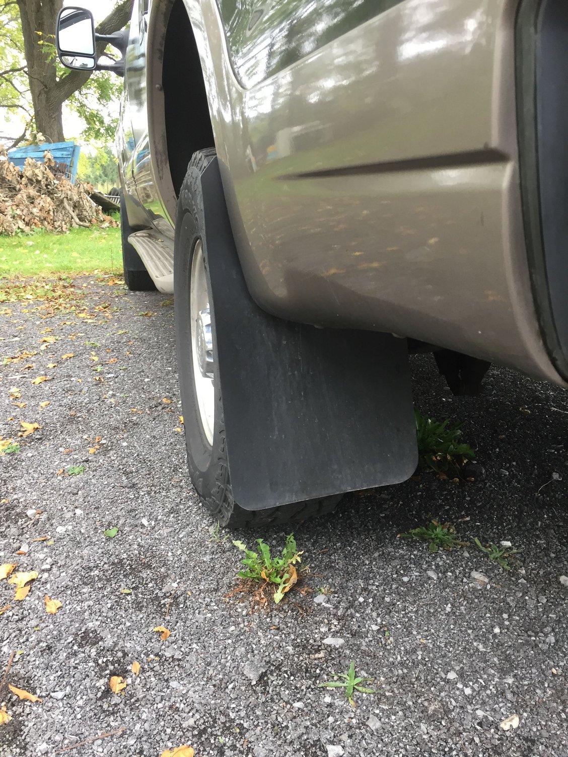

https://www.amazon.com/Rally-Armor-MF20-BAS-BLK-Universal-Hardware/dp/B07D73PHQX/ref=mp_s_a_1_5?keywords=rally+armor+basic+black&qid=1569763553&sr=8-5 https://www.amazon.com/Rally-Armor-MF20-BAS-BLK-Universal-Hardware/dp/B07D73PHQX/ref=mp_s_a_1_5?keywords=rally+armor+basic+black&qid=1569763553&sr=8-5
i have lived on the same kind of roads. Yes that rock and sand mix is rough.
I use these rally armor universals.
20” on trucks. 12” on minivan and crv
not the best for style but the stick out catches the debris
ill attach pics in a bit.

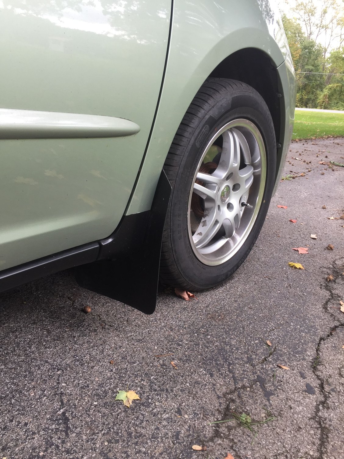

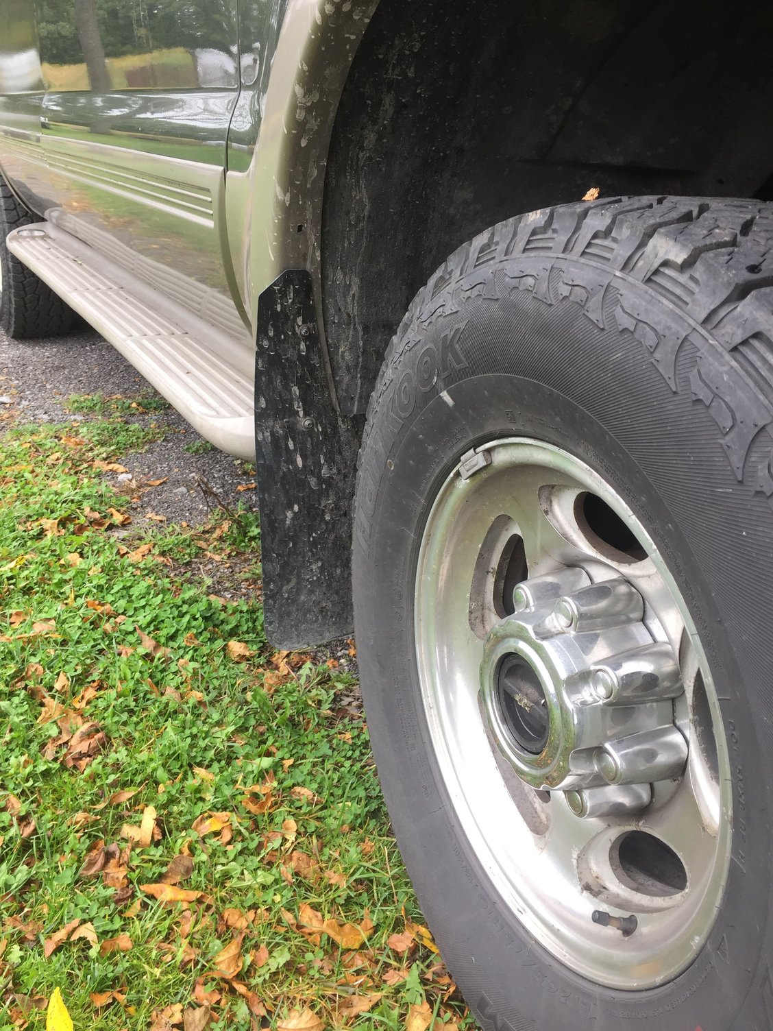

my goals are not show truck. Maintenance and longevity and rust prevention are tops for me.
i used metal roofing screws into fender skirt/liner metal backer fender and where the back up was only plastic I put a rectangular piece of aluminum sheet behind to make a sandwich.
this is the 12 size on my minivan. Wish I had put them on sooner. Rockers were getting beat to snot and rusting. 07 sienna.
