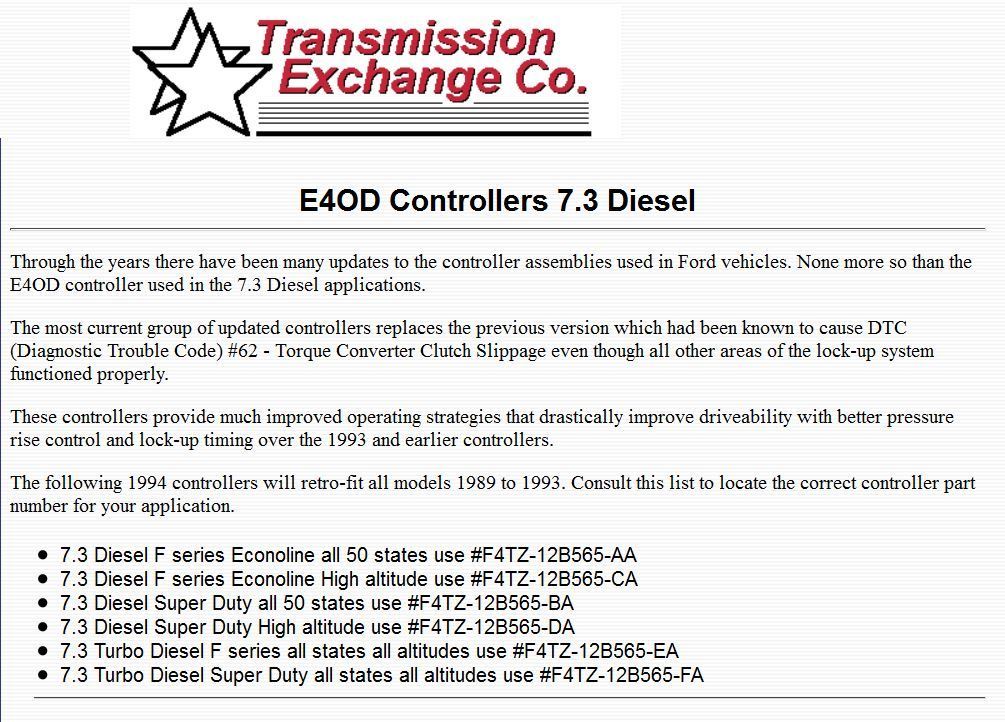

I don't know that number... but this is Ford's Last Replacement part number 7.3 Diesel F series Econoline all 50 states use #F4TZ-12B565-AA
Maybe Number Dummy .... Bill can shed some light on it ?
What I posted is per the Ford TSB 94-2-26

As I said I don't know that number (FOTF-12B565-AA) 3/4 ton or 1 ton is same difference. the latest Replacement that I Know that works on the 7.3 NA is the F4TZ-12B565-AA.... IF you have Turbo then ...........
  • 7.3 Turbo Diesel F series all states all altitudes use #F4TZ-12B565-EA <<<<==== this would be my guess for your Truck by your listing in your Signature
  • 7.3 Turbo Diesel Super Duty all states all altitudes use #F4TZ-12B565-FA

OK here is the Deal.... the one you pulled out was F4TF12B565AA <<=== this PCM is for Non-Turbo.... so my guess is that someone Before you just added the Turbo and did not Change to the correct PCM and I also wonder IF they even changed the Injection Pump.... the real difference in the PCM is just the shift points as far as I know.
so either one will probably work fine.... but not optimal for the application.

At least you know the PCM fixed the problems .... I would talk to the company and find out from them Exactly Why they say it will not work for your truck
the Base Number is 12B565.... the last 2 letters seem to indicate AA is for Naturally Aspirated BUT I'm not sure that those letters actually Mean that, I've never seen a break down of what all the digits and codes on the PCM mean from a Reliable source.
