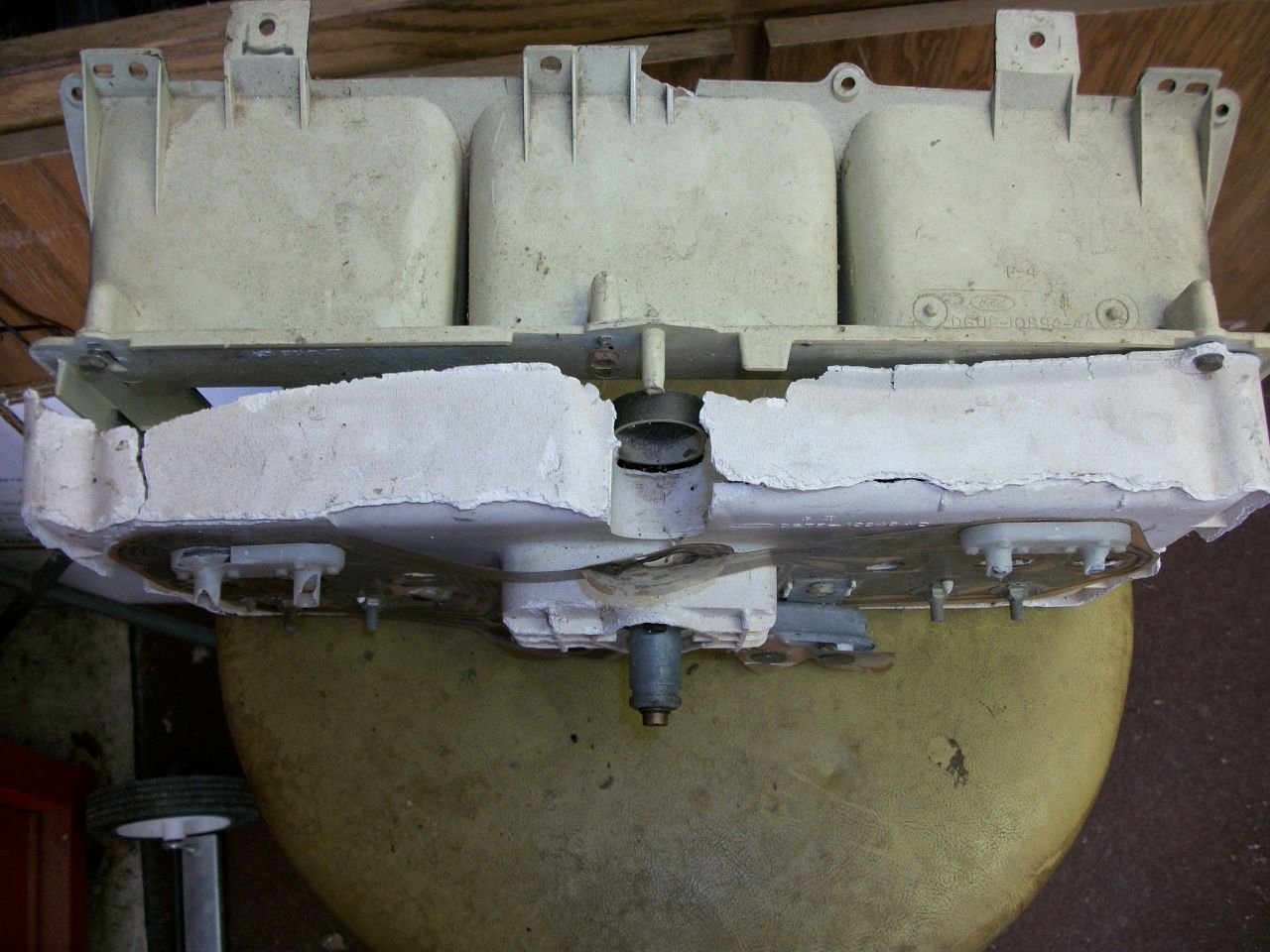

that is true ill have to double check tonight,when i went to remove the 78 cluster it turned into powder in my hands so i got a little rowdy with it on removal lol

Ah the ol dreaded dusty instrument cluster.. Yes there is a wiring difference in warning light versus gauges harness. And yes there is a pin count difference in the older cluster verses the newer one. I'd put the old complete wiring harness in the replacement cab and go from there. To remove the voltage regulator, pretty sure you have to do a 3G alternator upgrade. Lots of threads about it.
