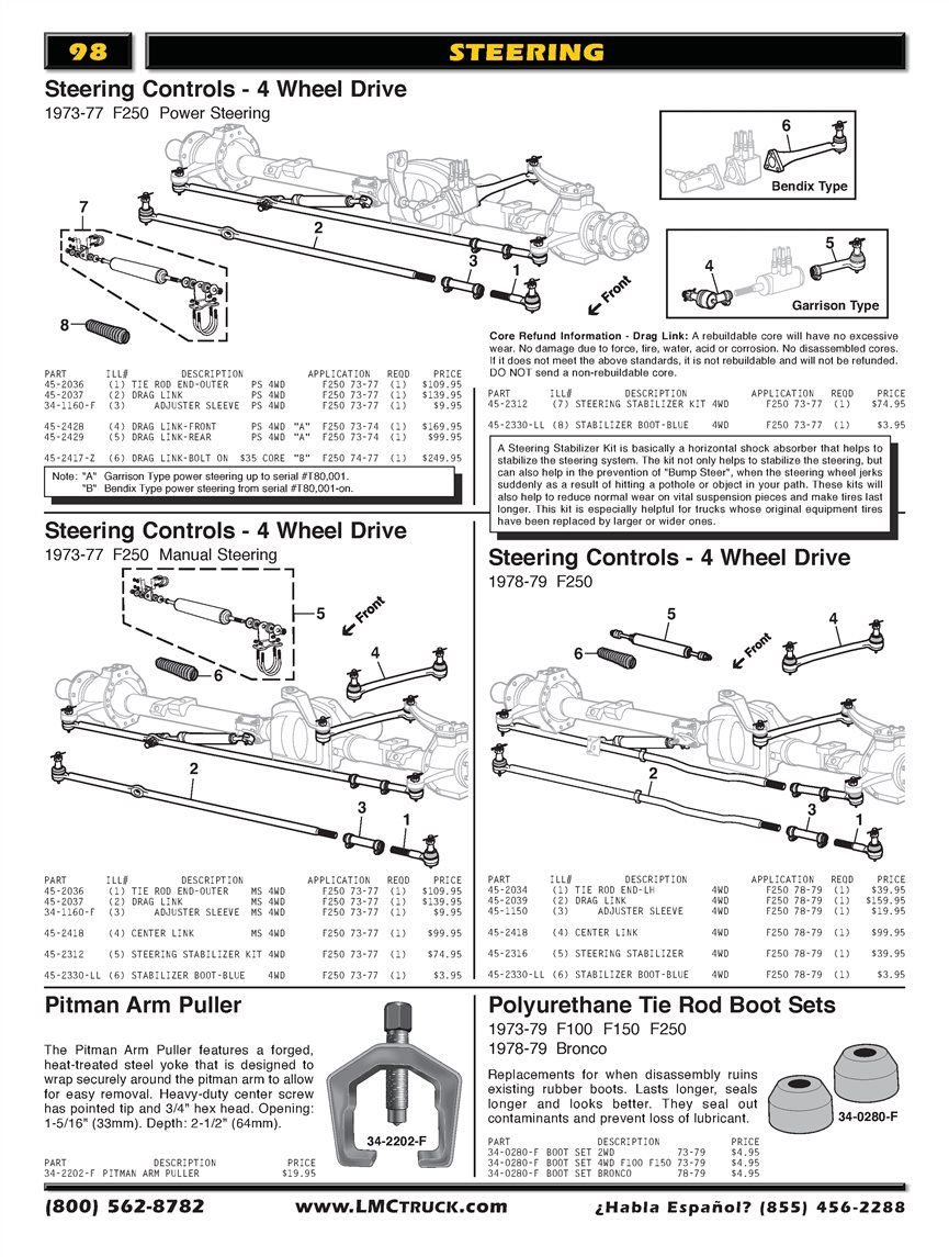

My drag link is bent, rn i am thinking that is the problem. not sure if trucks from my year are supposed to be bent or not. and yeah checked fluid and pump and no leakage. Checked my axle and it’s still in the same spot on my leaf springs, didn’t move.

75 is straight, 78/79 had some bend to clear the pumpkin. Here is a quick reference.
