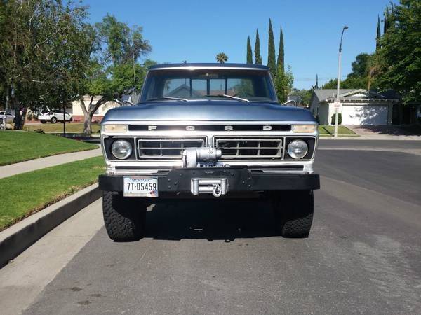

I have a front receiver welded to the front passenger side frame rail and spring hanger. It's a little set back from the push bars/guards and the bottom of the receiver sits about 2.5 - 3" below the bottom of the push bar but above the lower front frame crossbar.
It was there when I bought the truck. I've never used it and it's not centered, but it gives you an option to look at.

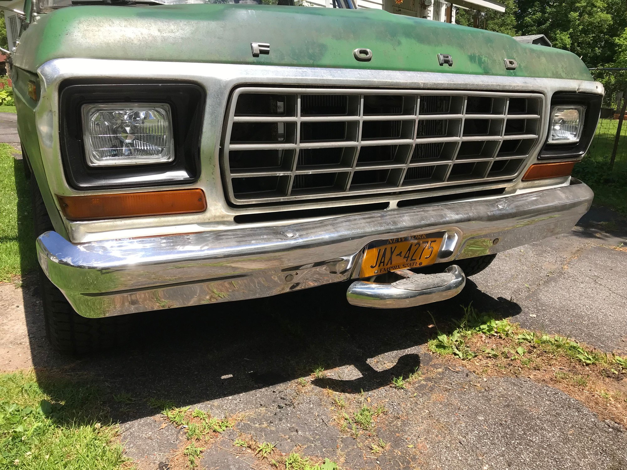

When I built the bumper for mine, I installed one just like this one. I welded it to the winch plate. The aftermarket used to sell them for trucks back in the 60's/70's. I knew a few people who had them on their trucks that owned travel trailers. Looks like your bumper is a good candidate for bolting/welding one under the center.

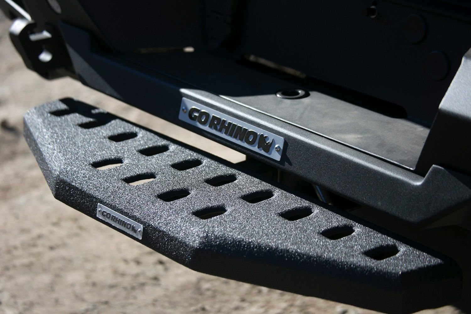

Jess

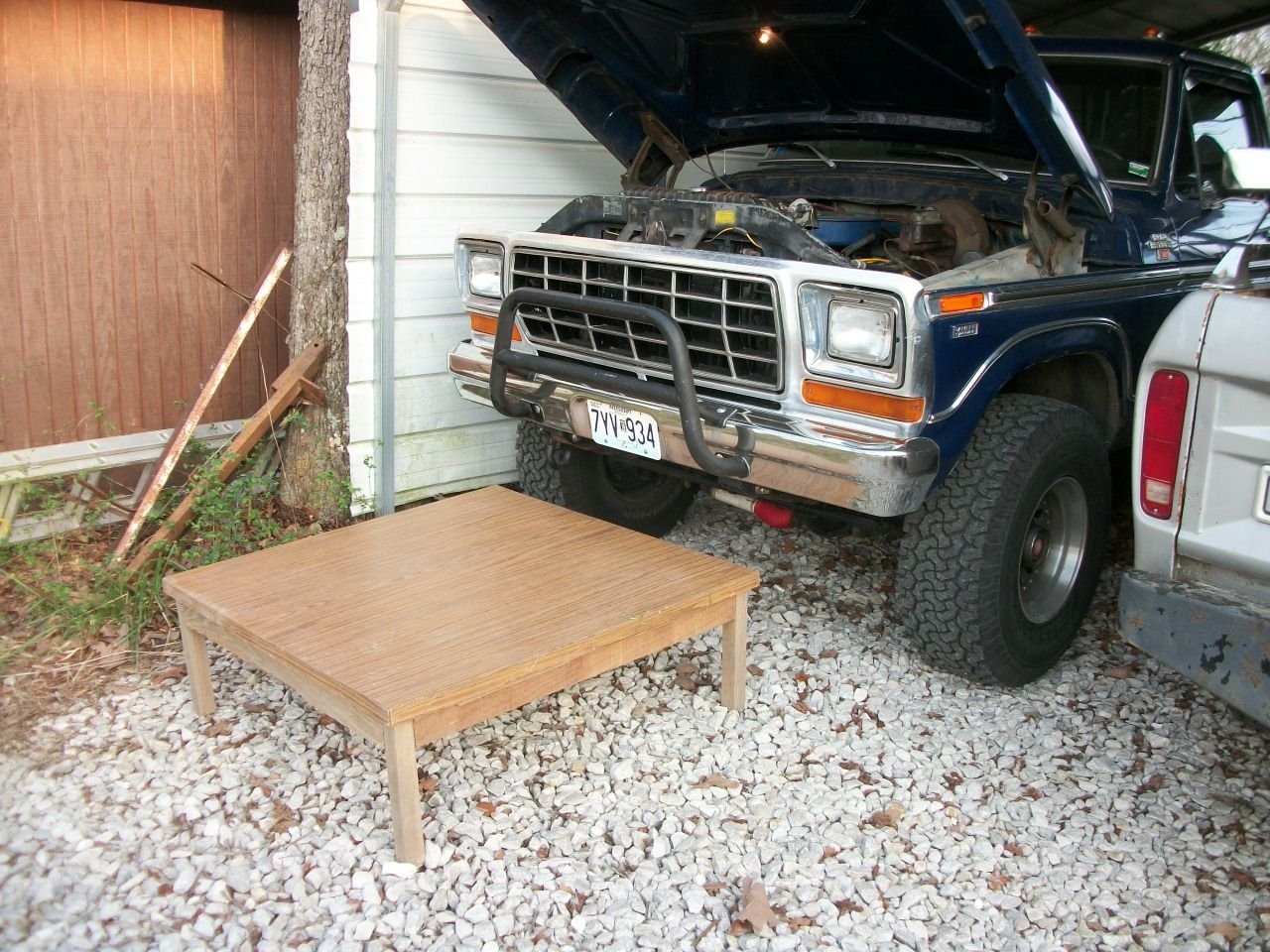

Ok I like this idea 29484848392x more now. I thought sure it'd be useful every now and again but then you went a put the hitch step in.... GENIUS!!! I hate either crawling up the truck or grabbing a step ladder. Highboy currently on 33s, moving up to 37s. Working on the engine bay sucks lol

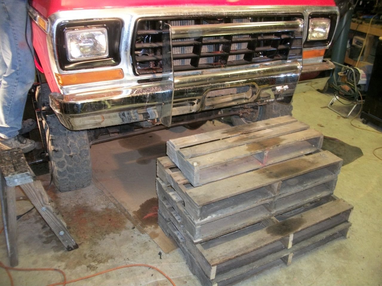

There are a ton of free ideas on how to make a step to put in there. Especially one that are not slippery when wet. And here are a few ideas when you are working on it at the house. I like to be able to set down and not work kneeling in the gravel all the time. Cheap pallet steps or a old piece of furniture. The ladder with the padded piece is pricey for us hard working types. Just wanted to show you the idea.
I have this one and it folds up flat to store in a tool box or behind the seat. It is what is being used in the far L/H side of the pic. I can even MAKE it fit on a 35x14.50x15 Bogger on the Bronco. If you got to looking at one you can make one easy enough too. But not as cheap as they are to just buy.
