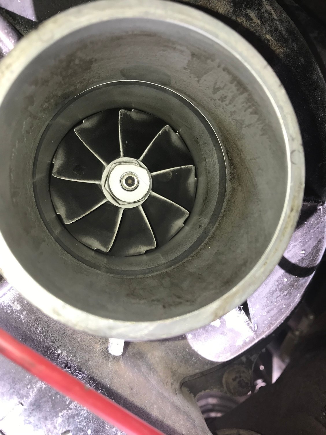

Looks worn to me but I am not sure what a good one looks like. Here is a picture.
I hate to be the guy but I wouldn’t run that anymore.
