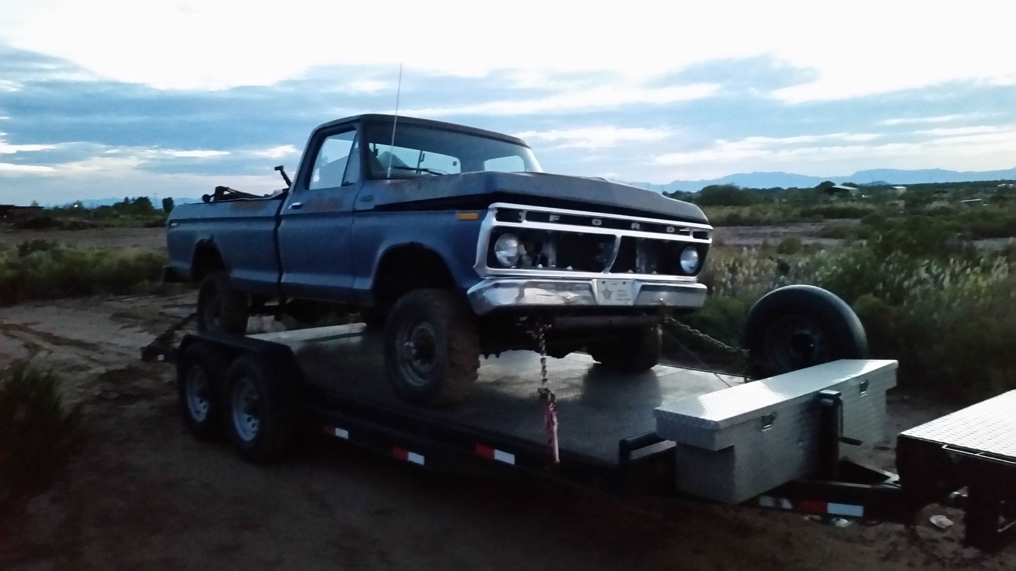

My father purchased a 1977 Ford F-250 new from Allen County Motors in Fort Wayne, Indiana. It was always in my life since I came along in the early 80s. It started to become a midwestern rust bucket as they all do in Indiana and I drove it when I got my license until 2001 when the 351M started to give up the ghost. I swapped in a used 351M, and new clutch, and new ignition parts, drive it about 3 miles to test it out, and it got parked when I joined the military in 2002. It sat in my parents yard until 2009 when I hauled it out west with good intentions. Unfortunately it sat, and sat awaiting being brought back to life. Finally in 2017 I hauled it to my house and out of the field it was stored in to start its resurrection.
Hauling the 77 F250 home
I got the truck to my house and I put some roller wheels and tires on it since the original 16.5" bias ply tires were not going to hold air. Then I unloaded all the parts that I had stored in the bed for many years.

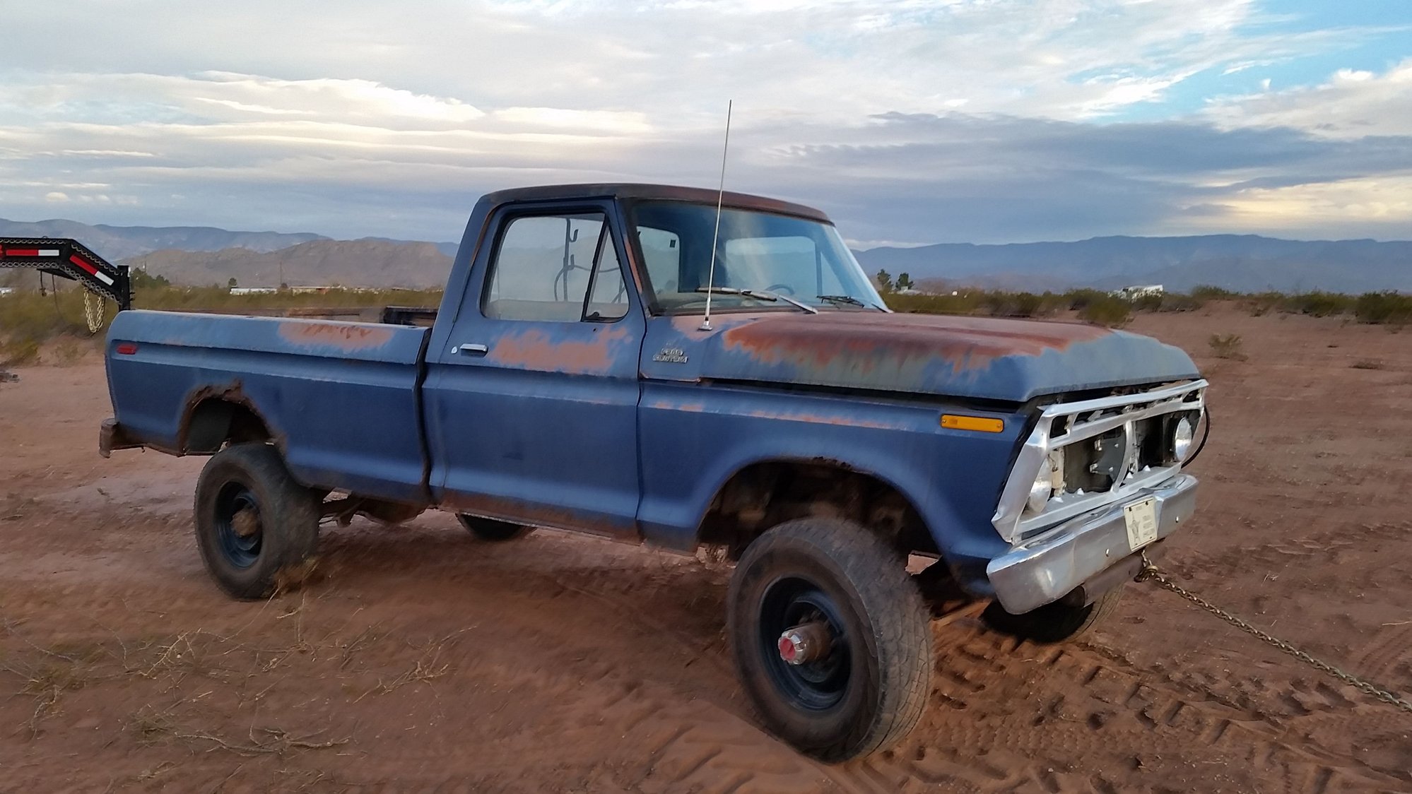

Unloaded and rolling again
After assessing the situation I realized that the condition of the power assist steering and brakes were too poor to repair economically just to make it drive again. I was going to have to really tear into it and do some work to make it right. I decided it was going to get a frame off restoration. I want to keep it fairly original but with a few upgrades such as fuel injection, overdrive, and air conditioning. I wanted the truck I remembered but a little bit better. lol.
The Indiana winters and salty roads had really taken its toll on everything so a parts truck would be needed for body parts.

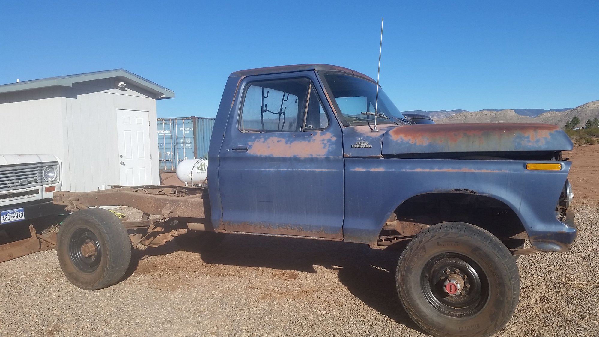

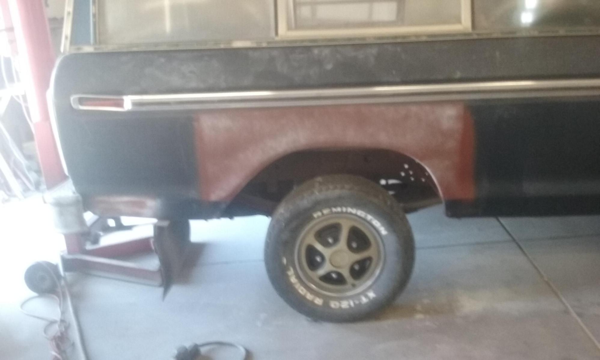

Last year I found a deal on a 2wd 1979 F-150 XLT Ranger in Colorado. It wasn't a perfect rust free truck but it was leaps and bounds better than what I had and only 67,000 original miles. So I bought it. The guy I got it from was a body guy so I included repairing the rear wheel well rust with repair panels I provided him into the sale price. His grandparents had bought it new in 1979.
Those hubcaps though!
It probably would run but moisture got to the carburetor and the throttle shaft was corroded fast.
I picked this truck because it had factory air conditioning, the price was right, and it was already blue.I am aware this wont bolt right onto the highboy frame. I will have some modifications to do.
New patch panel installed by previous owner.

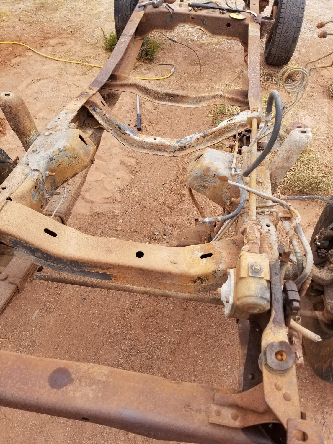

Rust on chassis
I also faced some frame rust on the 77 frame that was worse than I expected.
The corner gussets on the back part of the frame were almost gone!

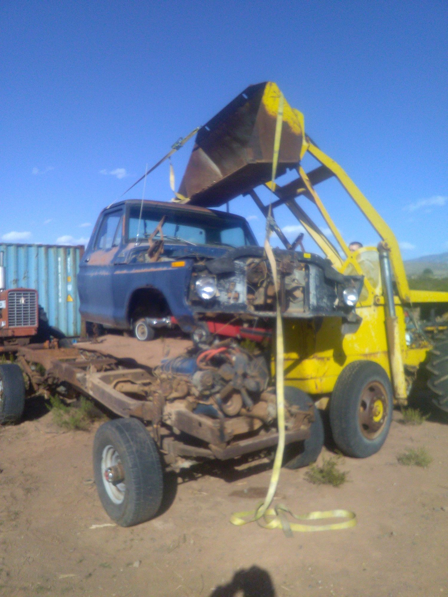

Removing the cab was a whole other pain in the butt. Only the rear body mount bolts came out freely. The fronts I had to use a Sawzall and went through a LOT of blades.
I finally got everything unhooked and lifted off the cab with my 1953 Hough loader. Its kind of a death trap but it gets the job done.
Lifting off the 77 cab
Under the cab I found more rust damage that concerned me. The rubber cab mounts had rusted out the mounting pads on the chassis. Looks like I need to weld in new metal, or find a parts chassis with good mounting surfaces.

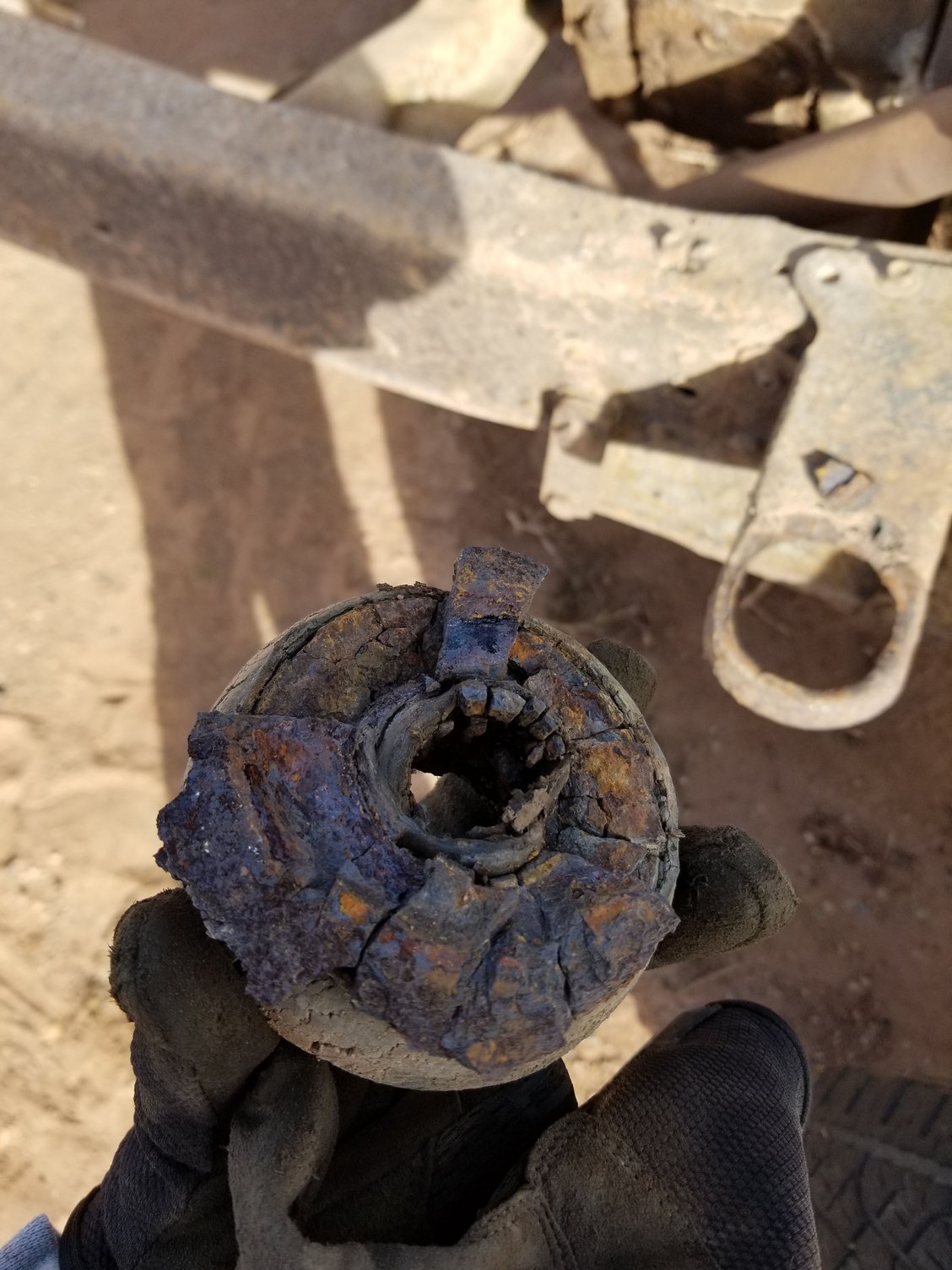

All of the cab mount brackets I took off my friends chassis still had rubber cab mounts in them. How hard could they be to remove? HA!!! I have all new rubber cab mounts so they need to come out. I put then in a press, I beat them with a hammer, I finally took a grinder and cut the top metal hat above the upper rubber into four pieces and it came apart. Unfortunately I don't think the new mounts come with the metal parts so I may need to find them. Luckily the cab mount brackets have nice clean holes and should work nicely.
