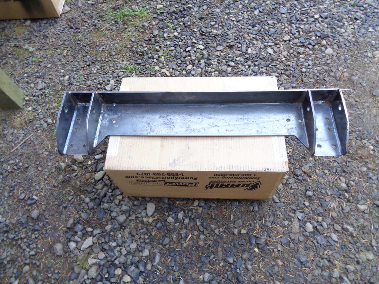

So I was removing the bumper from the 79 F150 parts truck to get it sandblasted with the other parts. I assumed the mounting brackets were highboy specific due to the frame width difference. But I noticed that the bumper is different width on its mounting area.
79 F150 bumper 37.5" wide.
77 F250 34" wide.
I suppose I could make spacers to use it. So does anyone know if the step bumpers are highboy specific?

I had a bumper I took of a new '79 and stored it for 40 years. the other day I put it on my high boy and as you say it was too wide for my brackets. I made a couple spacers out of flat bar, 3/4" as I recall and when you install it the brackets move to the inside so it fit perfect.

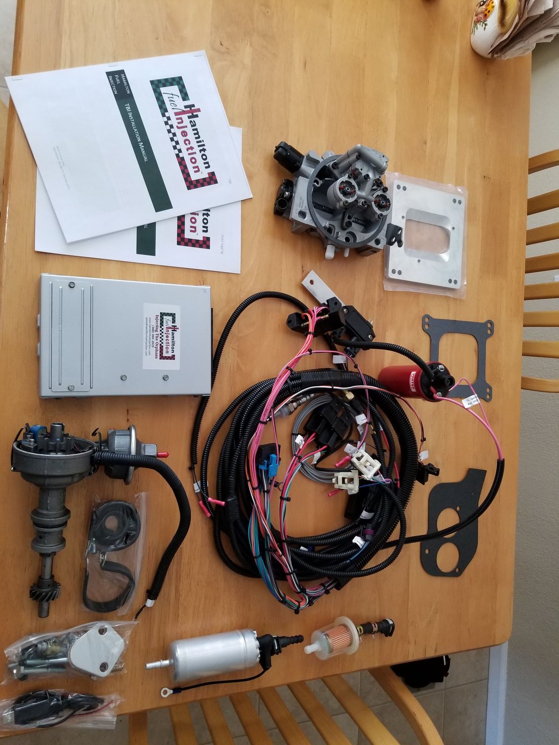

The other arrival was the fuel injection system from Hamilton Fuel Injection. He builds an awesome GM TBI fuel injection system catered towards your specific vehicle. New stand alone harness, troubleshooting just like a early 90s GM pickup, parts on the shelf as any auto parts store, and computer timing control.
I have his system on a couple of my IH trucks and it is great!
He specializes in the orphan vehicles like IH, AMC, Hudson etc but can do almost any. I had sent him a spare distributor to be converted.

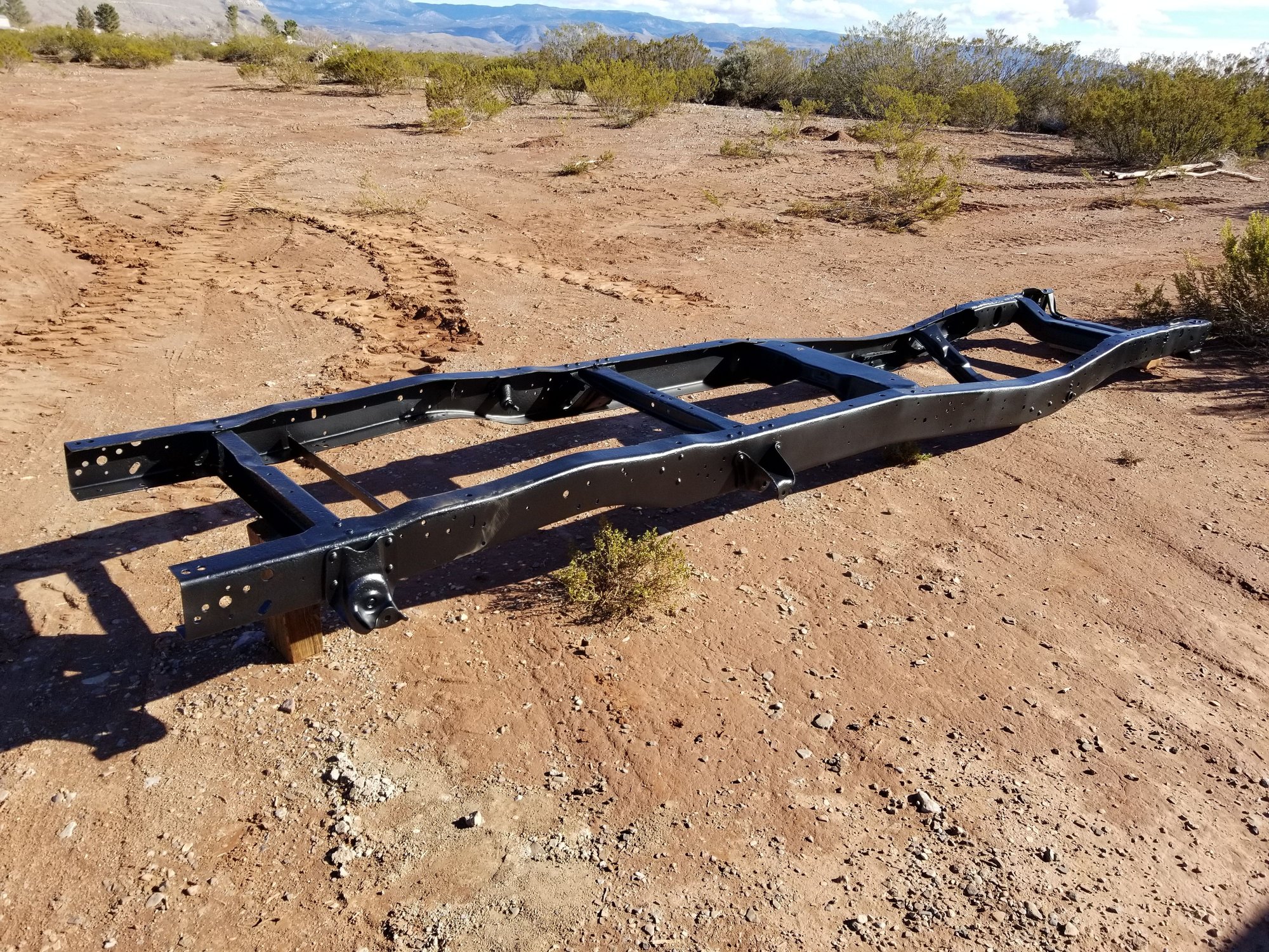

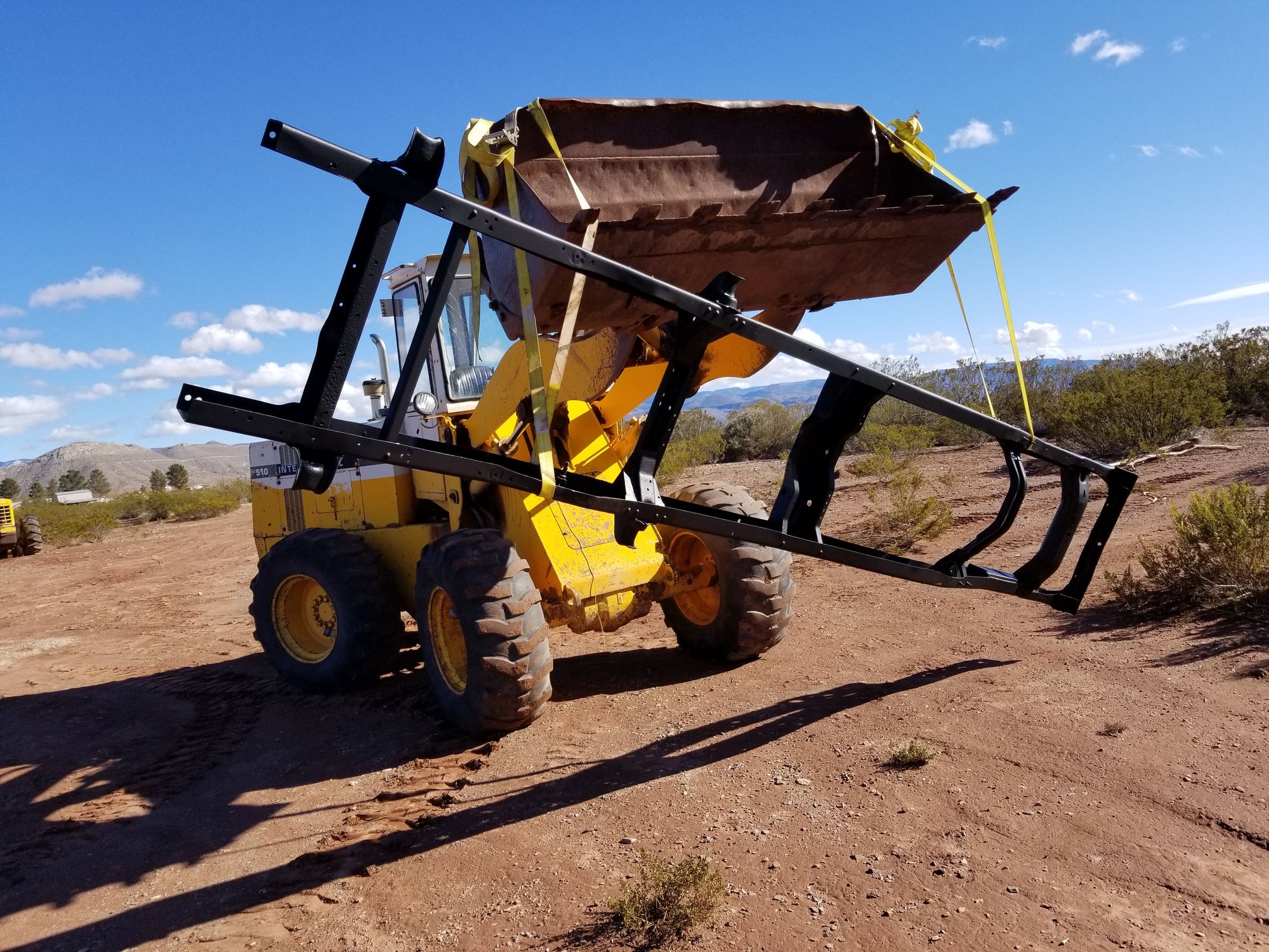

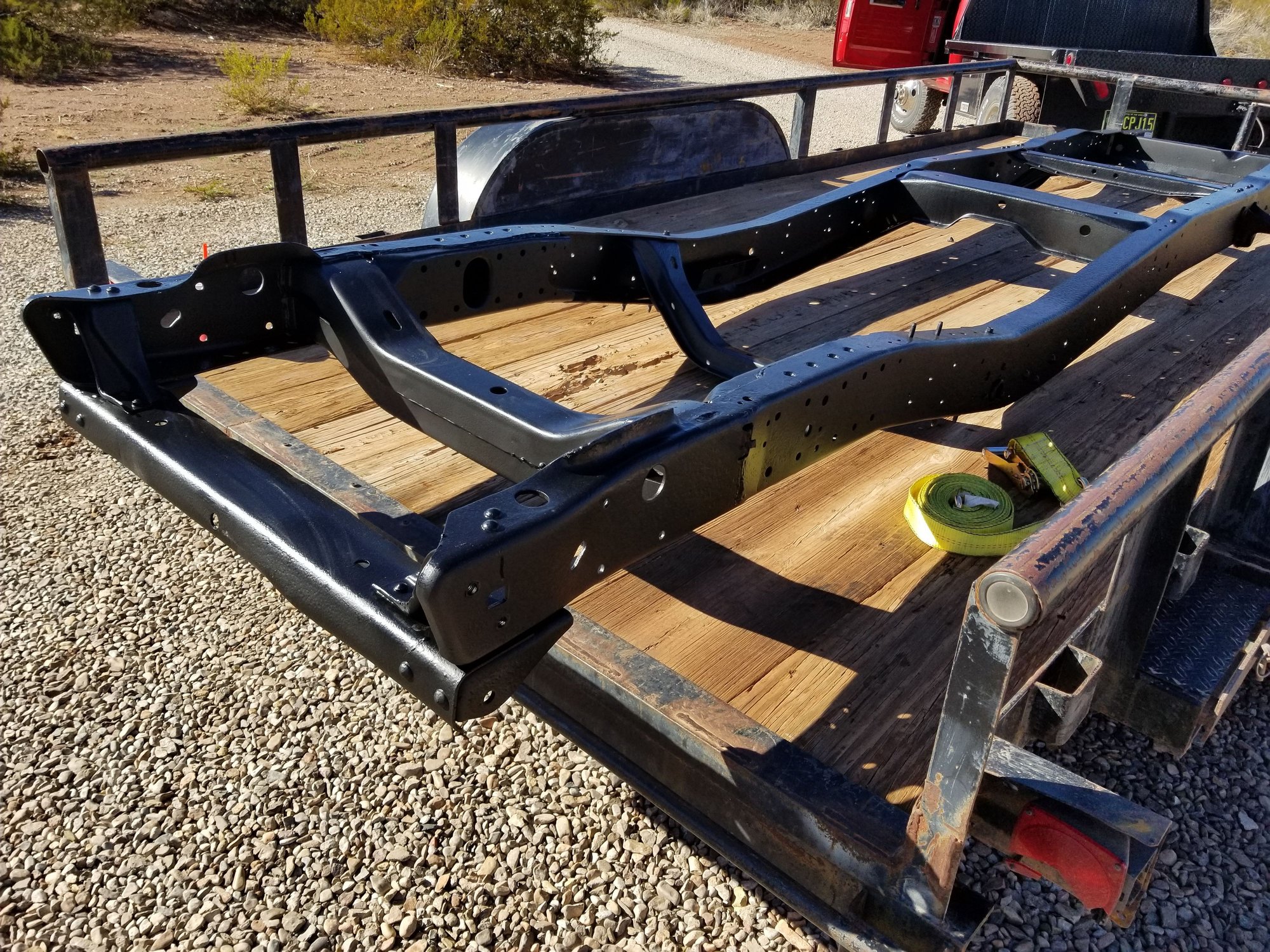

Picked up the chassis from the sandblaster yesterday. I had him do the painting. I had him use KBS Coatings Rust Seal over the blasted metal, and KBS Blacktop in chassis black color as a top coat.
Still waiting on axles, springs and miscellaneous parts. He does the blasting outside so since the weather here has not been cooperative he is behind.
My trailer was occupied so I had to borrow my friends trailer to bring it home.
Having a loader just makes life easier!
Chassis looks great! I am very happy with it. You can see a lot of the pitting from all the rust but it shouldn't ever rust again.
The blaster wasn't a fan of the KBS Coatings. He is used to regular paint and primer. But since I grew up in the rust belt and dont miss it a bit I insisted on the special coatings. For those that dont know KBS Coatings is very similar to POR-15, just a different brand.
