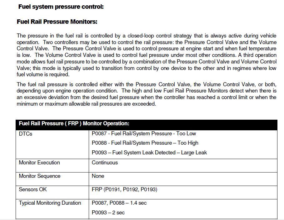

Only code so far is P0087 which appears to be a generic low Fuel pressure code?

Old Sep 15, 2019 | 05:19 PM
kper05's Avatar
kper05
Joined: Jan 2010
Posts: 6,600
Likes: 84
Fuel rail (these DTCs) is post HPFP correct? I'm thinking need to look at freeze frame data to see what the fuel pressure is vs what is being commanded.
