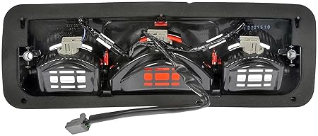

It's not a harness just a inline plug, the new lamp housing had a plug on it(like in your pic). On a scew you can't reach that plug without pulling the wire out of its holder or pulling the headliner. I wanted to plug it in rather than slice wires. Changed it because it was leaking, not the bulb going out.
