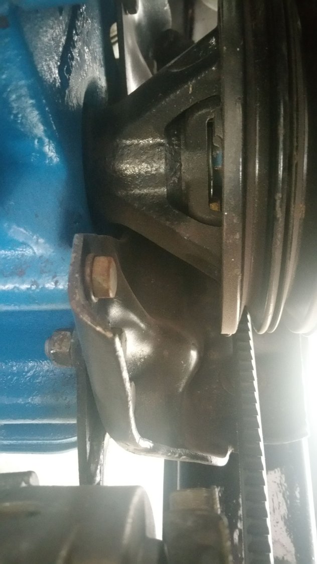

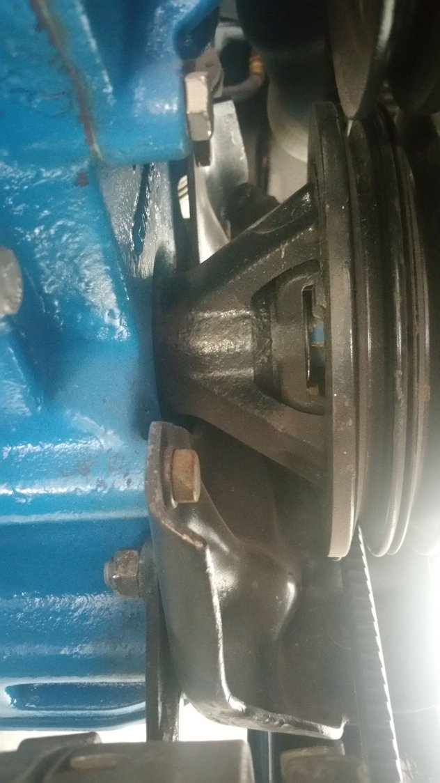

There are a couple possible dampers and a couple possible pointers. A picture should clarify that problem.
Old Sep 18, 2019 | 07:20 PM
rio68's Avatar
rio68
Joined: Jul 2015
Posts: 225
Here's a couple of pic's.....
Old Sep 18, 2019 | 07:30 PM
charliemccraney's Avatar
charliemccraney
Joined: Apr 2003
Posts: 2,389
Likes: 58
And how about the pointer?

By chance, someone posted this in the facebook group. That's what the pointer should look like for that damper.

Just to be clear, the pointer mounts to the lower bolts of the water pump, not exactly to the timing cover. If the pointer did not mount to those two bolts, then it is the wrong one for all dampers, not just the one that it is not fitting..

Found the pointer, I shorten the length from the water pump mount down to the damper and it worked out good. It was too long from the water pump down to the damper. Apparently the damper on the engine originally was smaller in circumference and the pointer had to be longer going down to it.

Does the pointer have multiple points like the one in the picture I posted? It must have that one in order to be able to time the engine correctly.
