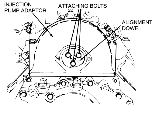

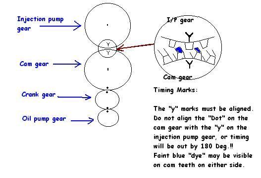

At some point someone may have pulled the pump mount housing off and could have gotten it a tooth off. You can check it without pulling the front end down. I would bet the bumpstick and crank are good. If you pull the pump mount housing off you can get pump drive gear timed. You can take an o ring pick and feel for the mark on the stick gear. A sharp pick and the one in a kit that has a slightly twisted end, will give you the best feel.
ya good Idea, with the dental Pic they can be a Bastid for sure, and I have personally seen folks get the gear off a couple teeth after the pump was removed, I would think it hard to do but there is enough play under that housing to do it, especially IF the tach sensor is out, some folks can lift the cover before they realize they didn't need to do that, and often it is easier to unscrew the lines from the injectors and just remove the whole assy (this is what I do on the JunkYard finds )
EDIT: you know what they say about a Cotton Field and an Anvil Never trust what the last guy did

I'm no rocket surgeon or brain scientist, but that looks to me like she off by a tooth or 2... Wife went to the bar said I can stay home and tinker with my truck... I got cold beer and dont like people

it's hard to say.... at least for my tired eyes from the picture ... I don't recall if the bolts are really Lined up precisely.
