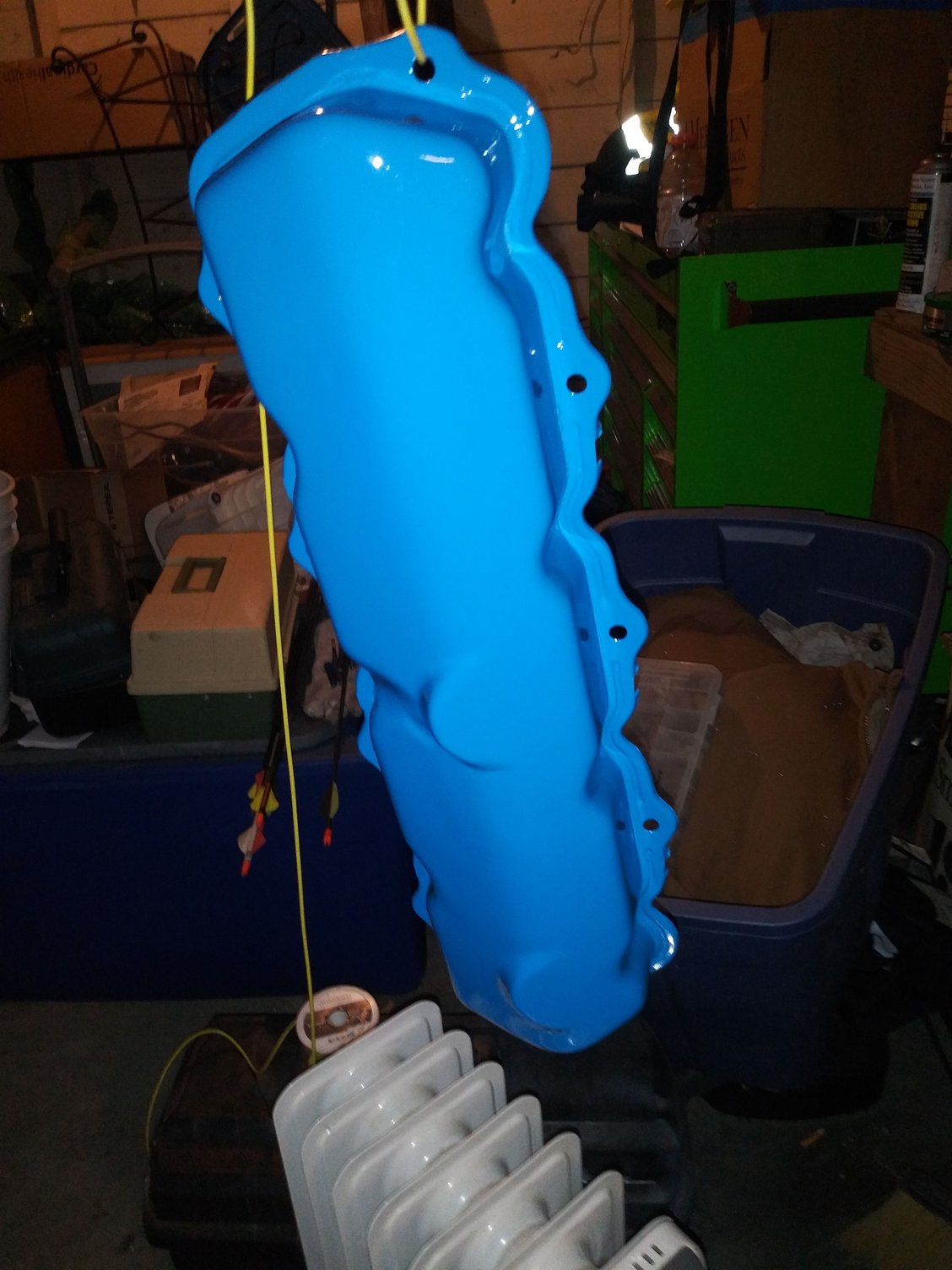

well its been a while since I posted and last worked on my smoke issue. Today hauled of a load of scrap. On my way home decided to try and figure out my unburnt fuel issues. So armed with a can of brake clean and the engine running I figured out I have a manifold leak. But also noticed a chuffing sound and kind of odd running behavior. Well pulled the passenger valve cover off and found the intake valve rocker extremely loose and the push rod sitting about 3/16 lower. Pulled the rockers and expected a bent rod. Straight as could be. Thinking I have a collapsed lifter. Doing a JY run next weekend to try a nab myself a turbo and some extra parts. In a slightly inhibited state I decided to paint the valve covers old school Ford blue... If I am going deep into this truck I might as well go all the way

well, you should have gone Corn Binder Grey LMAO but I guess any colour is fine .... and yes a collapsed lifter could cause the issue but you wouldn't always see that with a compression test but you should sure be able to hear it.

Its what we had in our "black hole" at my shop, stuff that was inventory but no longer in our system. And yes, I've seen it happen a gasser motors. Oh well, payday another $100 order to rockauto... Might put off the turbo till I get this old girl running spot on
