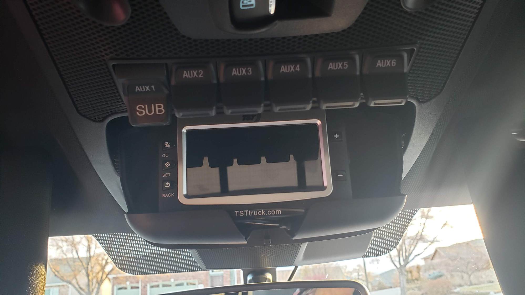

I'm just getting a TST TPMS going on my truck and this thread has some great info. Thanks.
I'm not a huge fan of mounting the receiver/screen such that it blocks my view, so has anyone tried mounting in the sunglass holder? Manos' mounting location is similar, but is outside of the holder.
I never use that thing and the unit fits perfectly there. Plus I can close it up out of the way when I don't need to see it.
Any thoughts??

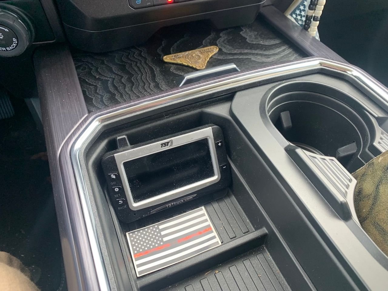

Mine sits in the left side of the console. 3m velcro to keep it from sliding around
