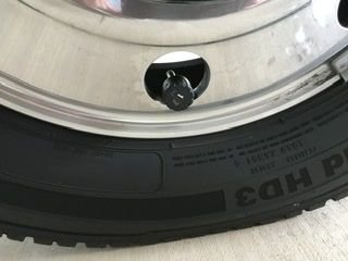

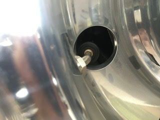

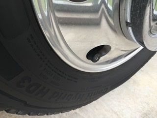

Here some pictures of the cap style sensors TST507 installed on my 450 . I left the front valve stem extensions on the front but will probably take them off . It will tuck the sensors back some which will look better. I took the factory extensions off the dually wheels . It’s a tight hit but I can take them on and off ok.
Rear outside
Rear inside
Front with factory extensions still on
Front wheel with factory extensions

Thanks for the photos!
It appears that you have had the outer rear wheels rotated so the valve stem do not line up, correct?

Sensors on my F450 look the same as CWTEX. I have not rotated the rear wheels; inner & outer valve stems in same hole. No problem putting the sensors on; just reach between the wheels. Mine are the old cap style, but I removed the security cover. New cap styles will not have the security cover, they will have a lock nut that you probably cannot use. I don't expect anyone to reach between my wheels and steal the sensors. I have had them on my trucks and RV for several years and have not lost one yet.
