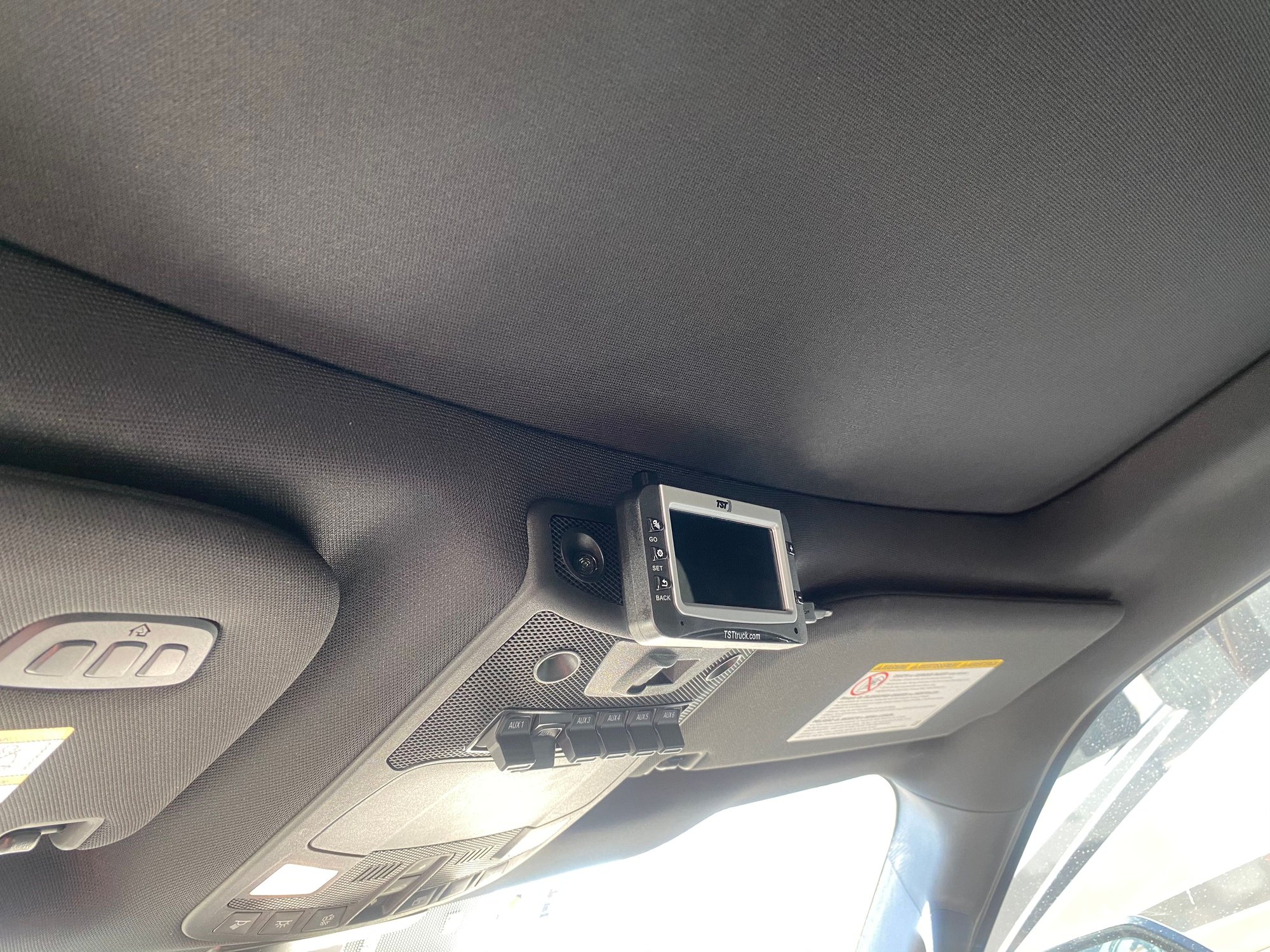

Mounted my display out of the way but still easy to check when we are pulling the 5th wheel. I also hate the wire clutter so I wired mine into the up fitter switches. i used the 3m picture hanging strips to mount the TST display and it has been holding like this for 6+ months in my 2019. The older non color style held like this for over 2 year in my 2017.
