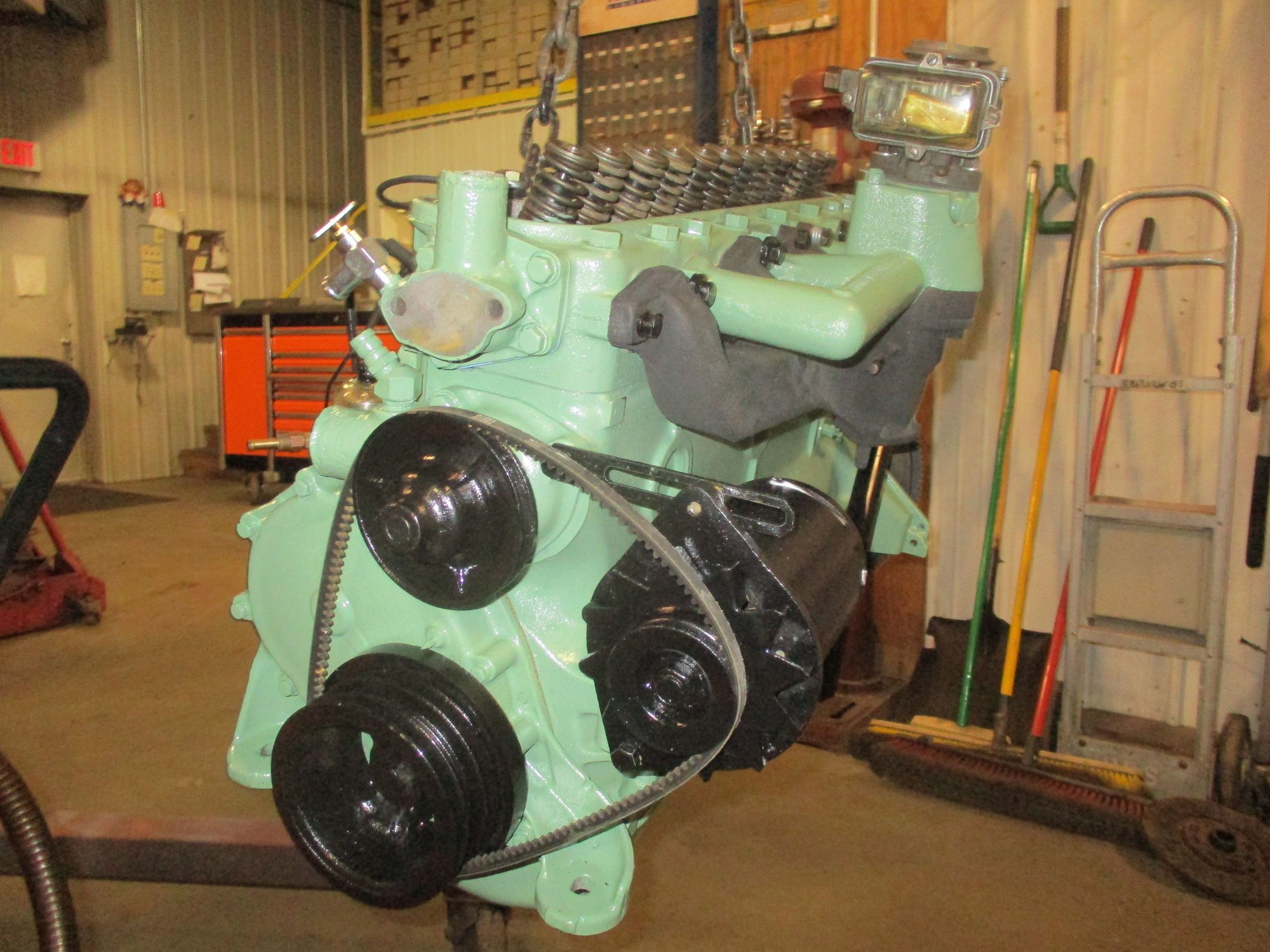

Here's a pic that shows the front of my engine. I guess the exhaust manifold isn't all that "black". The spray can said black, but when it was heat treated in my wife's oven (while she was away baby sitting grandchildren), it didn't stay black. It's even less black now.
Jim

I used Bill Hirsch paint--again following Stu's example. I'm four years and maybe 5,000 miles in, and I'm satisfied with how the Hirsch paint is holding up. My carb was leaking for most of those years and miles, and I also have numerous oil leaks. These issues have taken a toll, but I'm fairly confident that with a little cleaning and some touch up, my engine will still look very presentable. Heat did not seem to be an issue degrading the paint on the intake. Bill Hirsch advertises his engine paint as the best that money can buy, and I have no reason to dispute that claim. I'm certainly more satisfied with my engine paint choice then I am with what I used to paint the exhaust manifold. That was disappointing right out of my wife's oven. I followed the heat treat and prep instructions to the letter in that case.
