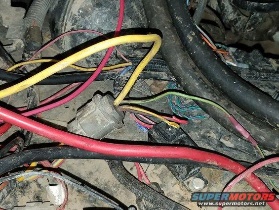

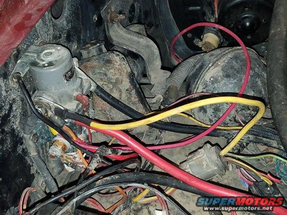

The big yellow wire is original to the vehicle. It normally went into a wrapped cluster of wires, if I remember right. I cut it and put an end on it so it could go onto the post on the solenoid for positive battery power.
You can see it going to the plug (that you should currently have). That plug goes into the cab wiring, etc.
The red and yellow wires are for the ammeter, and I just have them clipped. I think you can look up "3G install ammeter to voltmeter" to get some info. There's also a place that you can ship your ammeter to and they'll convert it to a voltmeter for you.

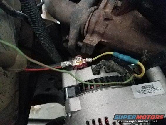

The green/red wire goes down to the 3G alternator. Mine was green/red on the alternator wiring too, so that made it easy to hook up.
