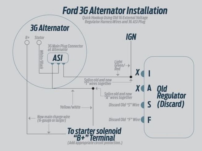

This diagram seems promising, you guys see anything wrong with this one or have anything to add on to it?

No, that looks correct. Just compare it against the one I posted, as well as the pictures, and it should get it all working.
Just be sure to upgrade to the 6 gauge or better that it recommends, as well as the fuse.
And again, if you get stuck, let me know. I can take pictures of my setup for you. Big fan of the 3G install.

Plan to do the 3g conversion myself at some point. Definitely saving this thread as I feel like I understood better how to do this from here than the other write ups.
Someone linked me to a pre made wire kit from like Dennis carpenter or somewhere else I may do that the build the harness this go around.
