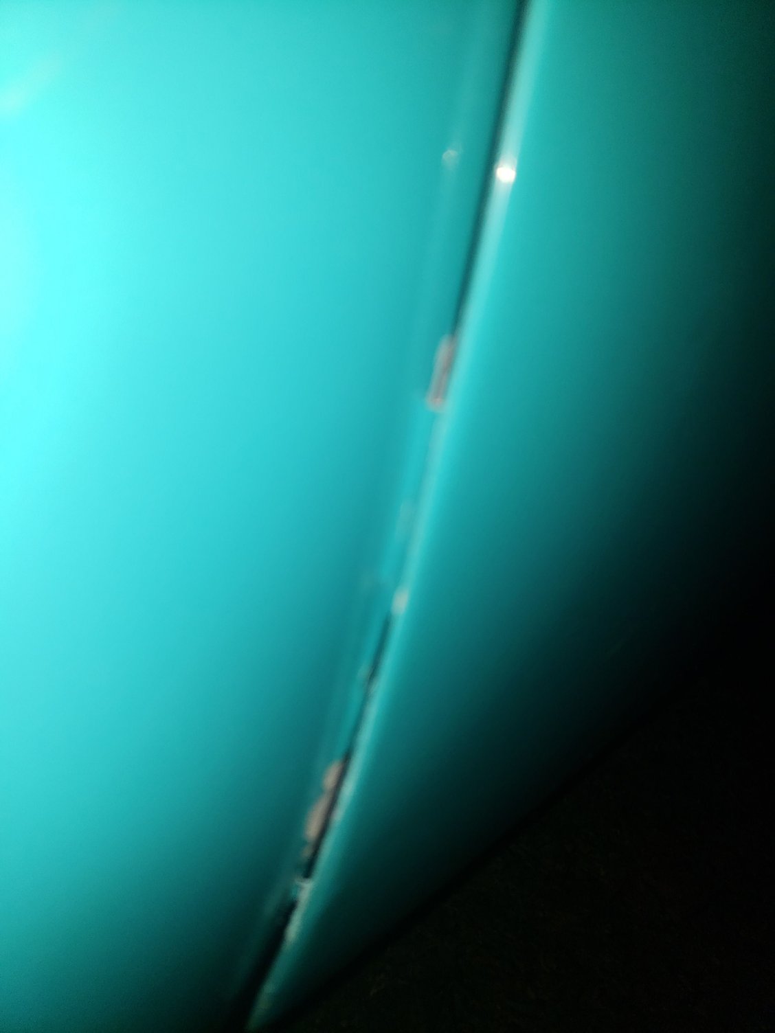

Bent door hinge
1966 150.
I was working on my 66 f150 today (putting new coil in)...I was rushing and left in neutral on incline under my car port.... truck went backwards and door hit pole and bent backwards... now it runs when opening and closing.
I saw videos online how to bend back on a different type of hinge.
Any ideas how to bend this back to make it not run and further destroy my paint.
Thanks all.
Opens and closes, door hits the fender

Sad opinion for you but it is possible that your bend is actually where the hinge bolts to the inside of the door and not the hinge itself.

Unless the light is playing tricks in your picture it appears that your door is what is bent and not the hinge. Compare that door with the other side and see if they are the same. The weakest part of the door mounting is the inside of the door where that hinge bolts to.

I don’t believe the jamb is bent. I wouldn’t mess with those hinges.
I’d get a used set, they are plentiful.
if you want new, LMC sells them but I don’t know about the quality.
Disassemble and assess exactly what’s bent.

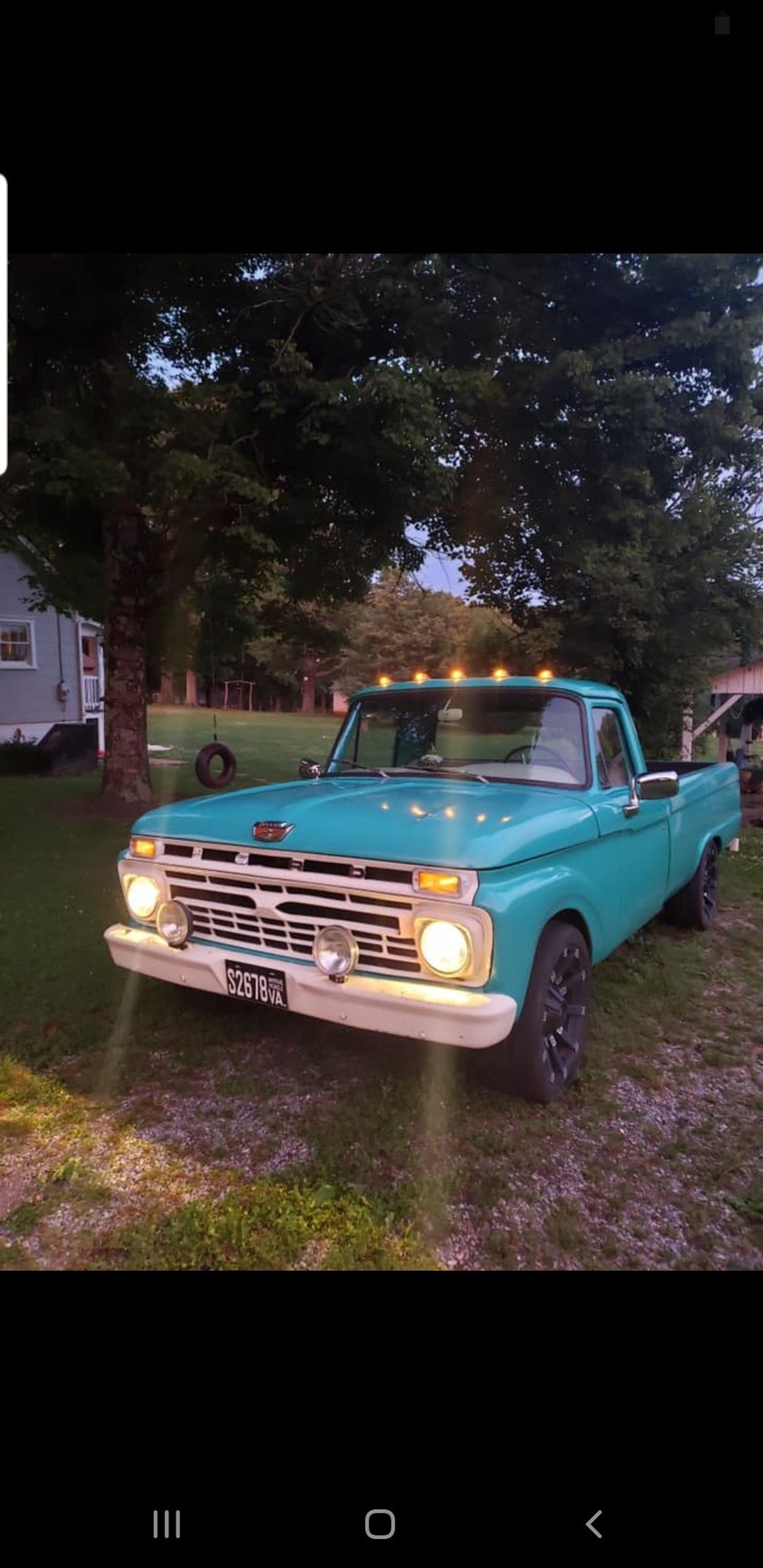

Thanks, I'll take a good photo of both sides when I'm home this evening!
Old Sep 1, 2019 | 08:57 AM
JEDIWZRD's Avatar
JEDIWZRD
Joined: Aug 2019
Posts: 4
A full photo to share with all, while im at it!

Tough looking truck.
Good eye. I didn't even notice that.
