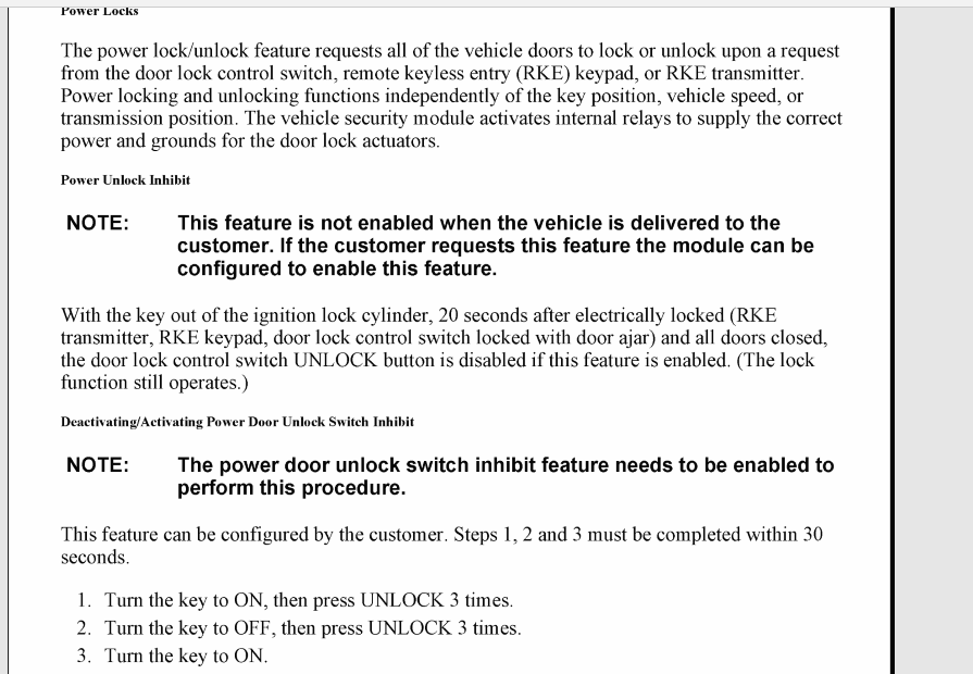

Hope this helps.

Originally Posted by jpv859
Hope this helps.
Your pictures won't show up because Alldata doesn't allow hotlinking.
