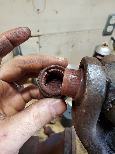

I had to park it this last winter because the steering became dangerous. It appears that it didn't get very much maintenance from its previous owners. It turns out that the steering problems were caused by seized up U-joints in the front axle shafts.
The rest of the front end wasn't in much better shape. The ball joints were going, one of the locking hubs was cracked, one wheel bearing was going, etc. I ended up rebuilding the whole front axle, along with new tie rods and drag link, new shocks, all new brakes - discs, calipers, brackets, and SS brake lines from PMF Suspension. I also dropped the drive line and replaced those U-joints and the hanger bearing, given the state of the front joints.

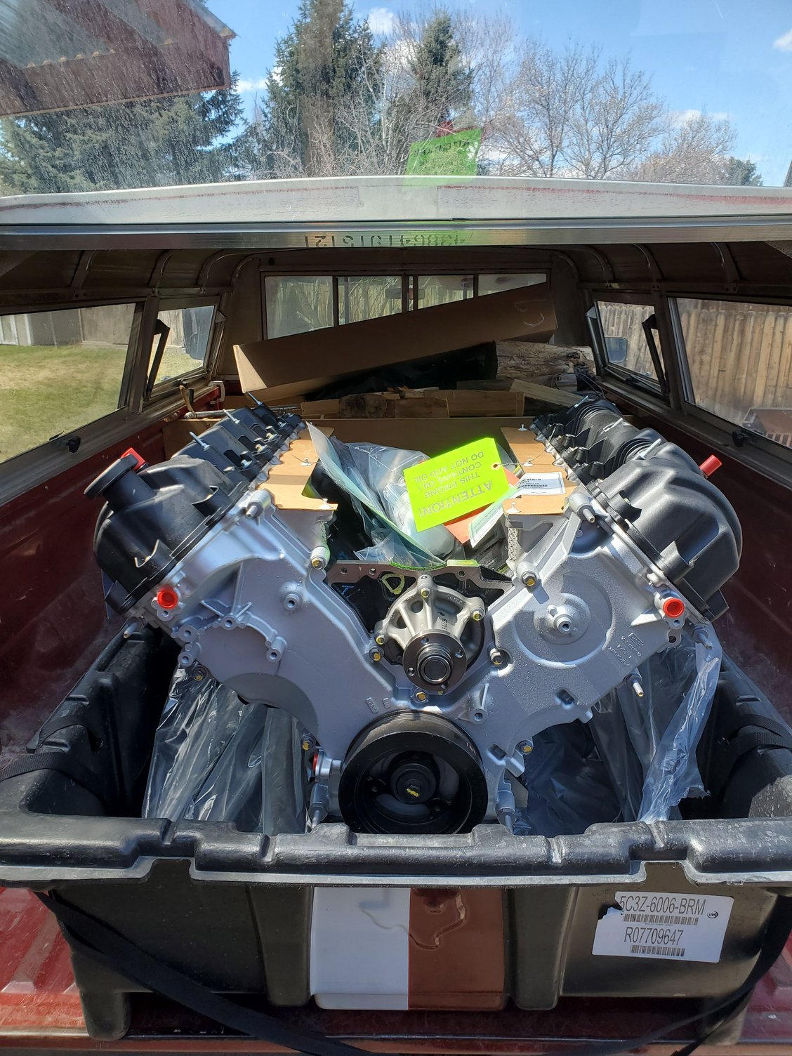

Well, I'm finally getting back around to this project. I decided my best option was a reman from Ford. No questions core refund and 3 year unlimited mileage warranty for 5300.00
Out with the old, in with the reman.
