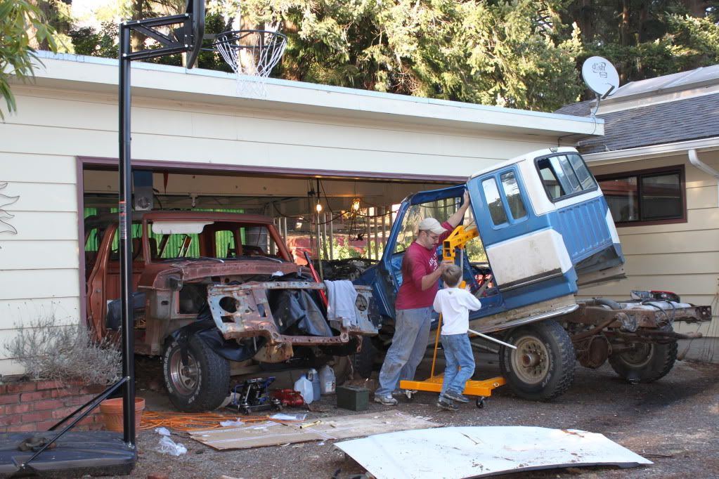

Ah you know me well don't you. lol Both ways will work and there are even more ideas. I'd remove the hood, then the complete front clip and go from there.
Walk thru front clip removal #1 https://www.ford-trucks.com/forums/1...l#post14982711
Front clip #2 in case I missed something. https://www.ford-trucks.com/forums/1...l#post14696880
Pics of how to with a cherry picker. https://www.ford-trucks.com/forums/1...l#post14696917
A lot of FTE folks have done it numerous ways. Ya just have to be smart and safe about it. The guy and his kid right there, NOT so safe IMO. The lower the truck frame to the ground less altitude to travel ='s easier. Put the truck on some bare tireless rims, low ride it if you are doing a static frame swap.
