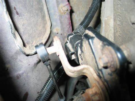

I remember when I helped my mechanic friend remove and replace the E4OD on my 1996 truck. There was a plastic box on the left side of the trans where the shift cable connected to. It had a electrical plug on it which sent the electrical signal to the inside of the E4OD to tell the electronics which gear to use. Here is a link:
https://www.ebay.com/itm/4R100-E4OD-...-/350988047294
This is it mounted on the trans outside, obviously...I am Capt. Obvious.

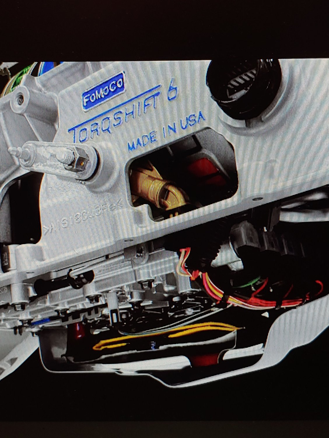

It appears they went internal with the new 6R140 trans. Here's some pics:
Here's a link for the 6R140 Range sensor:
https://www.buffaloengine.com/catalo...0-range-sensor
It looks a lot like the external 5R110 range sensor but they put it inside to keep it lubed inside the trans fluid I'm guessing. So you and Kper may have intermittent issues with it.
