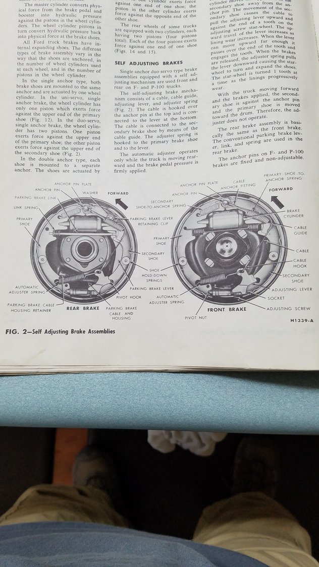

Ok, so how come it shows self adjusting brakes in the 1965 manual?
F100 2WD's had 'em in 1965, F100 4WD's did not.
See 2A176/2A177 - 2A178 - 2A179 in parts catalog pic:
