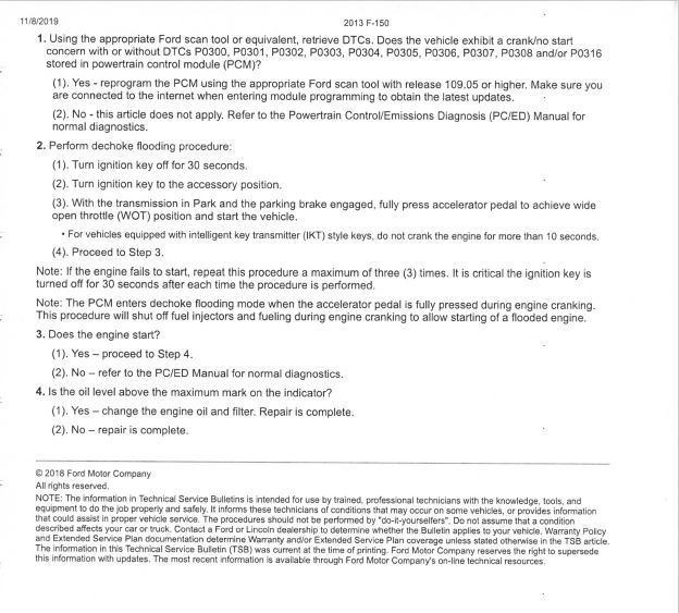

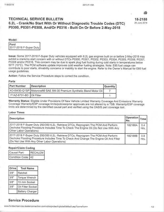

TSB 18-2188 below. My 2017 6.2 never exhibited crank/no start (nor long crank) problems, but did pop the Check Engine Light with p0300, p0303, and p0316 codes earlier this week after a cold morning start. No other symptoms noted. Dealer reflashed my PCM today per the TSB. The TSB does seem to imply an oil overfill can contribute to the problem, but not the case for my truck. I'll let everyone know if the problem returns...
