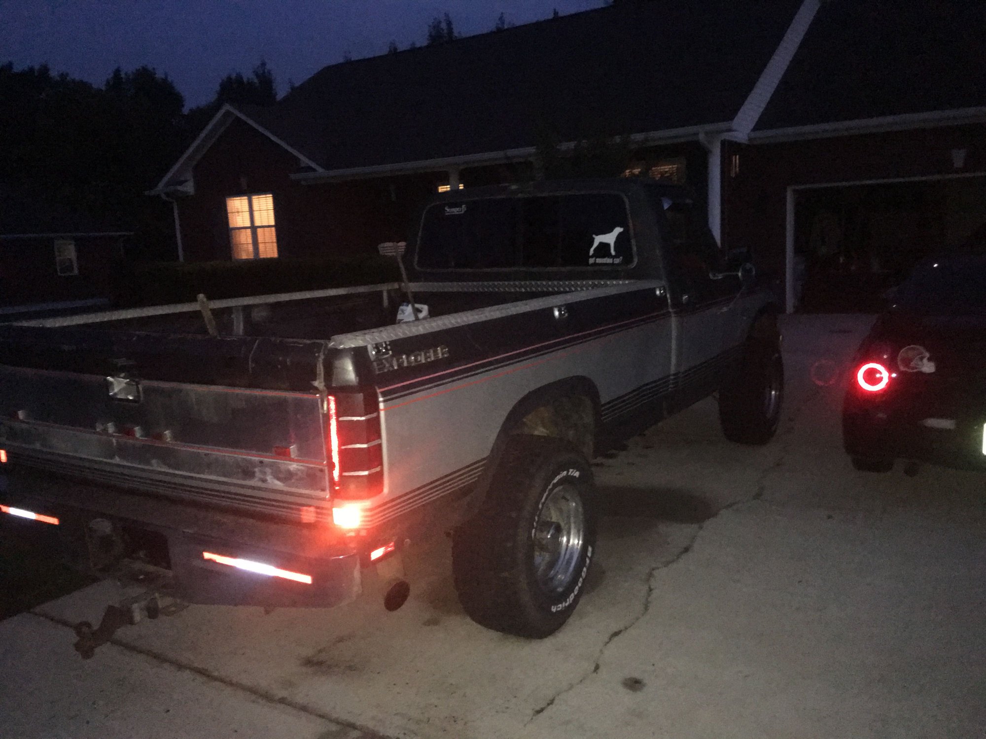

Good day everyone I’m in a bit of a pickle when I acquired my 85 f250 it had aftermarket wheels and tires 33 12.5 16.5 well guess what no one makes that tire. Any idea if pull off wheels and tires from a 99 gmc 2500 would fit same lug pattern 8 6.5 Or is there any other options keep in mind it’s a hunting and farm truck so cheap

The GM wheels wont fit, the hub center hole is too small, same for dodge. 16.5 is available, just uncommon and expensive unless you run military surplus tires.

with the 16.5's you can run Military tires at the Cost of 700 bux each ..... OUCH
while the 8 6.5 pattern may be same the Hub hole center may be Different....
I had that issue with trying to put a wheel from an 83 F350 on to a 93 F250 the 83 Hub Hole size was too small to fit the 93 F250.... it would at least go on the front as a temp spare.

Thank you all.. yeah I knew about the military tires but ouch is right I guess I’m going to have to bite the bullet and by new wheels and tires

Loved em but hit a axe head while on a coon hunt I live in north alabama so you never know what your tires will find while in the woods any ideas what i would have to do to fit the 37,s on it pretty sure it has a lift but could be wrong
