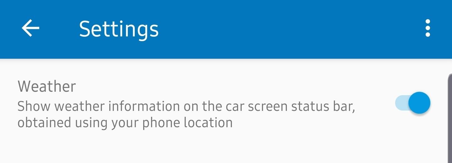

Not sure when the latest update rolled out, but I am now seeing the Temp in the top right corner of Android Auto now.

No temp display on mine, in either our truck or Expedition.

Check your AA Settings, there will be a weather setting like the below (based on your version)...

Yes! The temp display on the new AA is a nice addition. I had to toggle mine on in the settings once the phone was plugged up.
