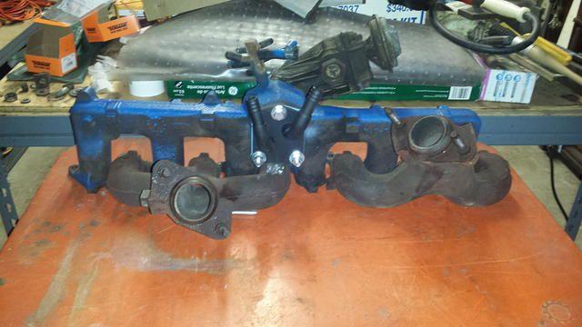

As for the EFI manifolds: It does have it's own issues. You need 3 or 4 hands to install as now you are dealing with 3 manifolds NOT bolted together.
There is no heating of the bottom of the intake manifold because they are not bolted together. This is only an issue if you drive when it is cold / cool & damp as it can lead to icing of the carb & manifold BUT there is a work around. At 1 time you could buy a plate that bolts to the bottom of the intake that you run heater hoses to and that would heat the intake manifold.
If you cant find this plate on line it is not hard to make using the gasket as a pattern to cut from a steel or Alum. plate and drill & tap for hose barbs.
It is said to use studs, nuts and the old thick washers. You can hang the gaskets on the studs, then with you 3 or 4 hands fit the manifolds up to the head, thick washer and nut to hold everything in place.
I have done this 3 times and it is only hard the first time as you don't know just how it all fits together. Some may even bolt the Y pipe to the manifolds to make them as 1 so now you are dealing with 2 manifolds and not 3.
That brings us to the Y pipe, you can only buy it with the cat and that is how it is listed when looking of it. It has been posted where the 2 pipes join the hole in the 1 pipe is really small and needs to be opened up, mine was ok and I did not use the cat ( not running any).
They say the EFI exh. manifolds flow better to give the motor a little boost in power but I can not tell you how much as I have not driven my truck with either set of manifolds, I have not driven my truck at all and I have had it since Dec 2015.
The reason I went with the EFI manifolds was the motor in my truck was changed an the factory front head pipe would not fit the manifold on the motor. I had a radiator a member needed and he the manifolds so we did a swap. I had to buy the Y pipe and the studs & nuts.
The Y pipe fit up to the newish exh. system I pulled from a parts truck with a short pipe and 2 clamps so I used all factory parts for the exh. system.
If it was not for that head pipe & manifold miss match I would not have gone with the EFI manifolds.
Manifolds & Y pipe
Hot water plate
Studs in head & gasket hanging on them
All bolted to the head
You can get the manifolds & Y pipe from the junk yard or buy new on line.
Dave ----
