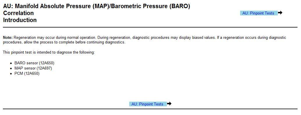

Appears the BARO might be part of the PCM.

As I said, I believe it is part of the PCM. Not a separate item.
If you notice the basic part number (12A650) of the PCM and BARO are the same. To me, this indicates the BARO is located within the PCM.

Yep. The PCED explicitly states that the BARO sensor is integral to the PCM.

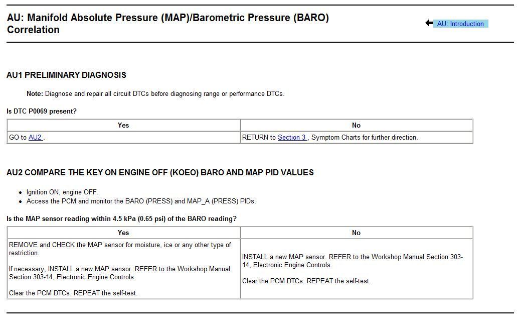

Did you use FORScan and look a the PIDs in the trouble shooting I posted?

You can get an OBDII adapter and FORScan for a smartphone/tablet that might let you view the PIDs.

I recently had a p0069
short version of the story…
if you have scan software and can setup a monitor for map pressure ….monitor the map pressure at shut down…if the map pressure drops to 6 or 7 at shut down ..remove the oring from the map sensor and clear the code.
