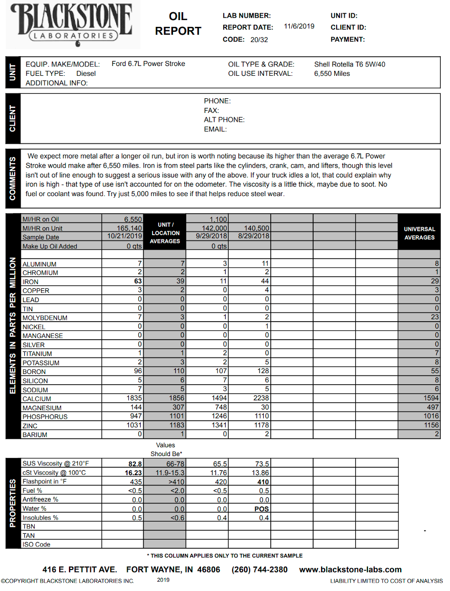

I have attached my oil report. It also includes my last 2 test. It doesn't look to far out of the ordinary but I am far from an expert.

lower your oil change interval and keep your idling down.
That is about all that I see. That high iron is concerning without a reason for it.
I would pull another sample at 1K miles on it.

I did break a injector hold down bolt on the first injector change. Plus I did the injector three times.
I wonder if it's possible I dropped some iron dust in while I was doing all this work. I had to use an easy out to tap the broke bolt and back it out.
I will do another oil analysis at 1k like you suggested.
