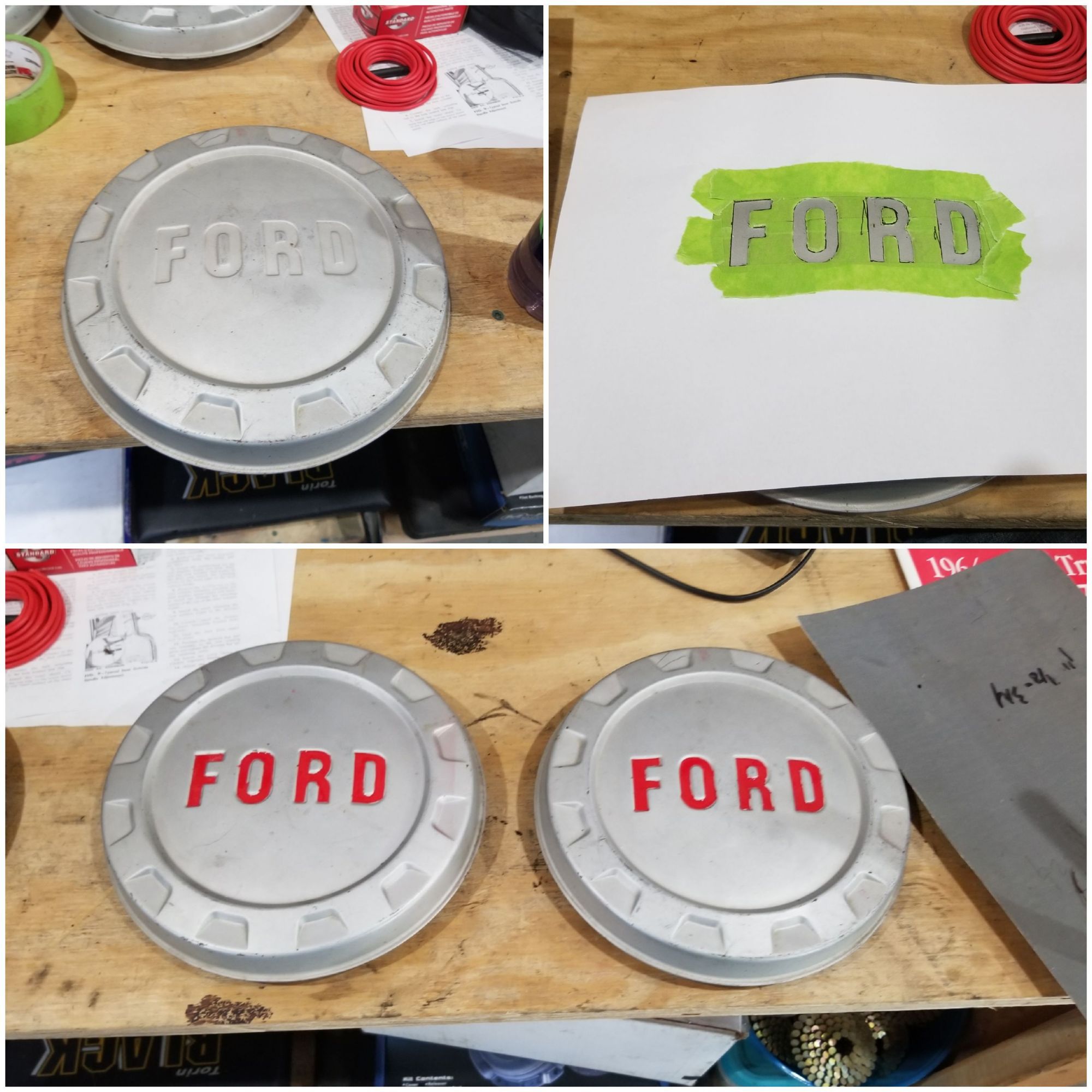

Got the hub caps done today. They didnt turn out too bad for a backyard amateur rattle canner ha. They'll do for the time being until I get the truck repainted and wheels / hub caps powder coated.

Anyone have photos of the Ford factory method of masking and painting hubcaps?
Eric
Eric
Not sure if it's the best way, but what I did was completely cover the letters in painter's tape, and then took a pen to outline the edges of the indentations, then took a razor blade to cut out around the letter edges where I had just marked prior. Then took paper to cover the rest of the cap.
