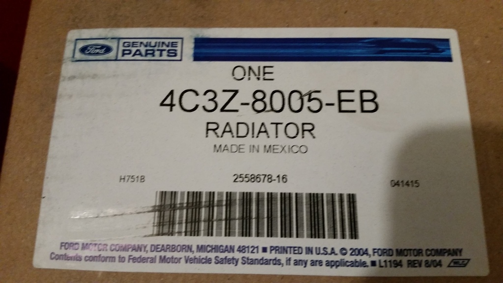

Anyone have a ford part # for the thicker (2 - 3/16") radiator?

Originally Posted by Bently_Coop
Radiator is here, need to call Horizon tomorrow about the transmission hard lines for it then install this weekend.
Attachment 217621
This is what Ford sold me in 2016 when upgrading my 99 V10 to a radiator with OTW cooler
