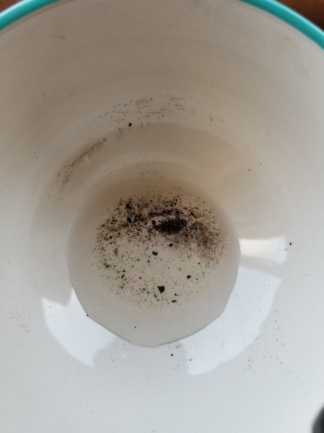

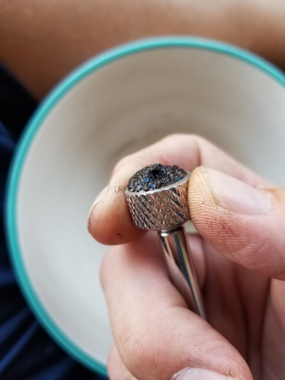

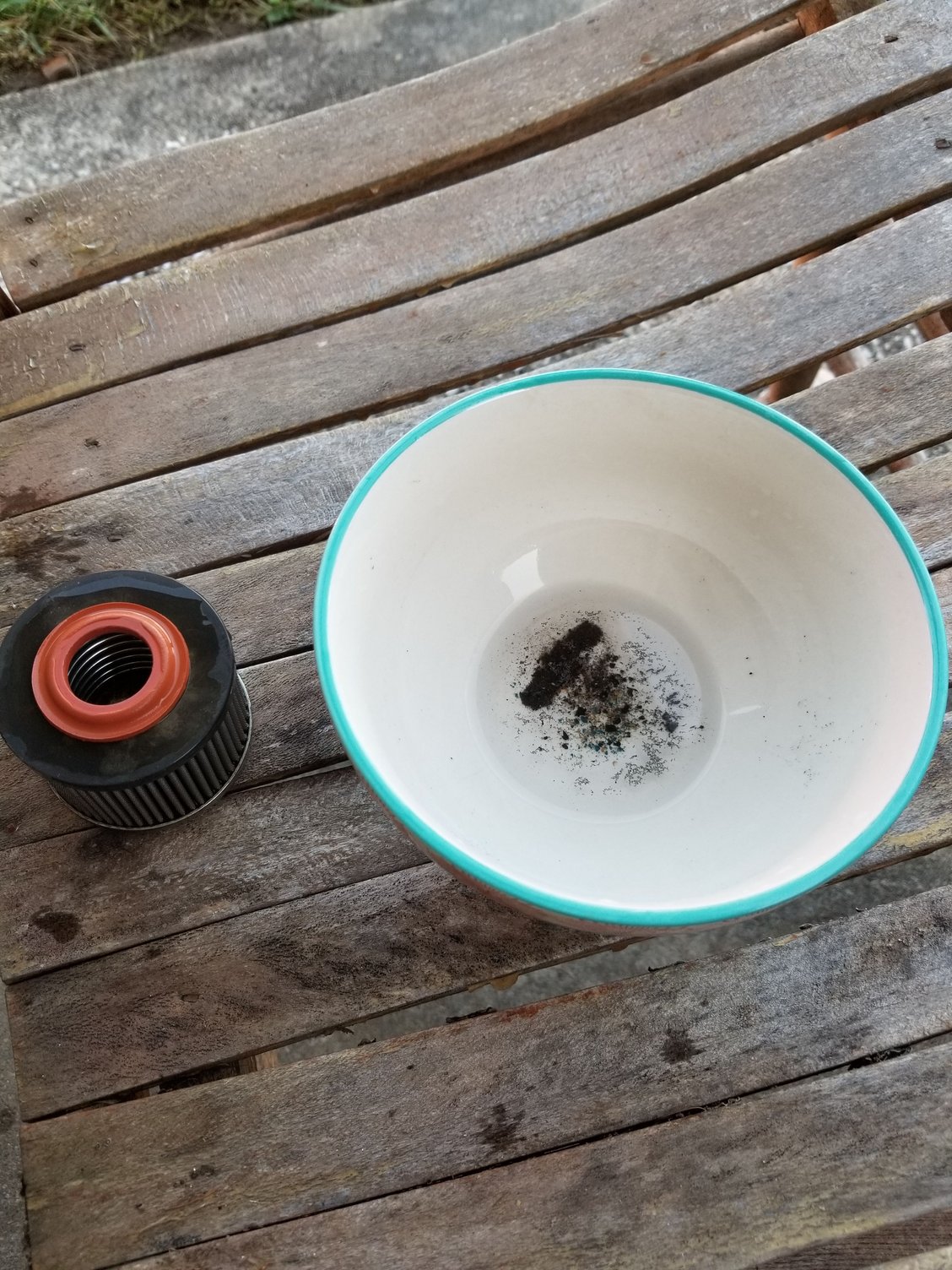

Started on the flush. Cleaned the coolant filter and definitely not happy about my findings.
Not as much gold flakes as last time but I did find some blue stuff and the only thing I can think of that would be that color is head gaskets.

How much of that is magnetic?

Most of it Bis.

Iron oxide is magnetic. The blue may, or may not be an issue. The main area of the gaskets does have coolant moving through. It's a very small amount, but it's there, somewhat acts as a cooling medium for the head gaskets per the guys at Felpro and over at Federal-Moguls engine test lab (different sites). Which kind of makes me wonder if Cosmetic with it's full covering is doing anyone favors.
You could be showing the residual from squeeze out, at the fire ring or the sealing rings.
The iron oxide, well .....
Can't leave me like that TMT. Iron oxide, well what??
Block flakes or what?
Appreciate the info as I go fellas.
