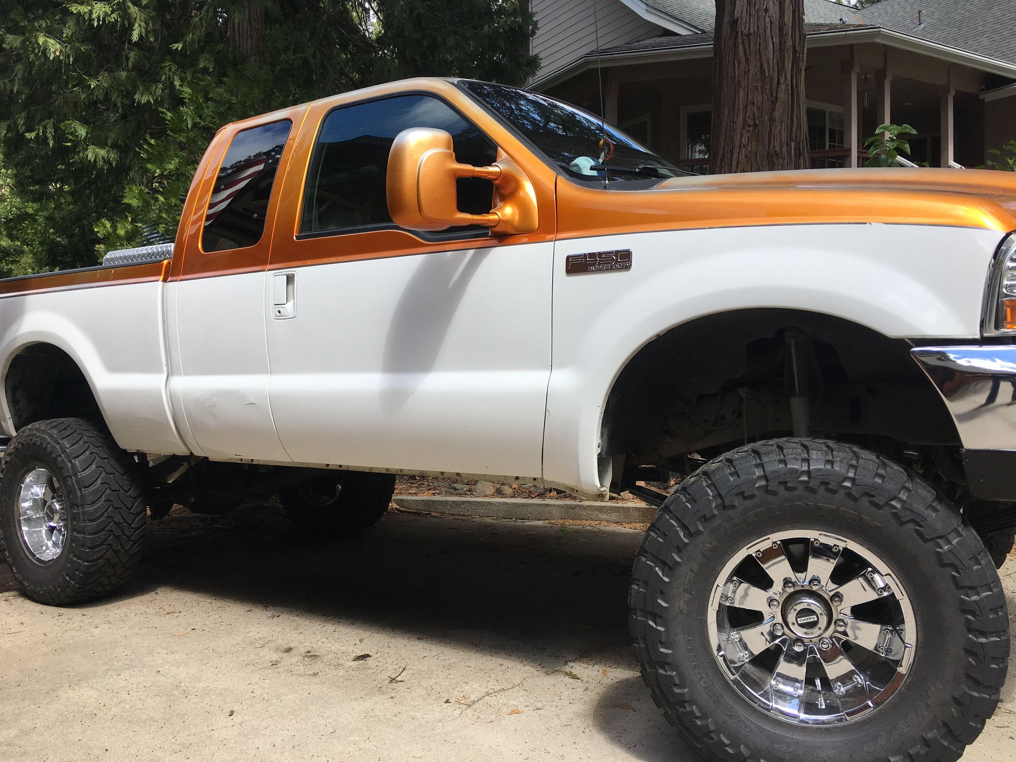

I have a 2001 250 7.3... I have a small fiber glass boat that I pull sometimes and my truck doesn’t like it... I have an 8 inch lift on 37” tires with 3.73 ratio. I understand the tires and lift don’t help it, but the boat doesn’t weigh more than 1,500 lbs (?)... do I have some other issues with my truck??? I know I need to rehear it to accommodate the tires, but I’m taking the lift off going smaller and downsizing tires maybe to 33”.
Additionally when I’m just driving the truck the transmission temp get up to about •200 and when the engine temp gets half way in 90+ weather some starts squealing when I’m on the throttle, but goes away when I let up...

Great pics! Love the paint job on the truck and boat. Your toenails, well, you do you and go big!
How are you getting trans temps? Please don't say dash gauge.
Squeal I'm thinking more like a weak belt tensioner. Dunno how that could be related to high trans temps.

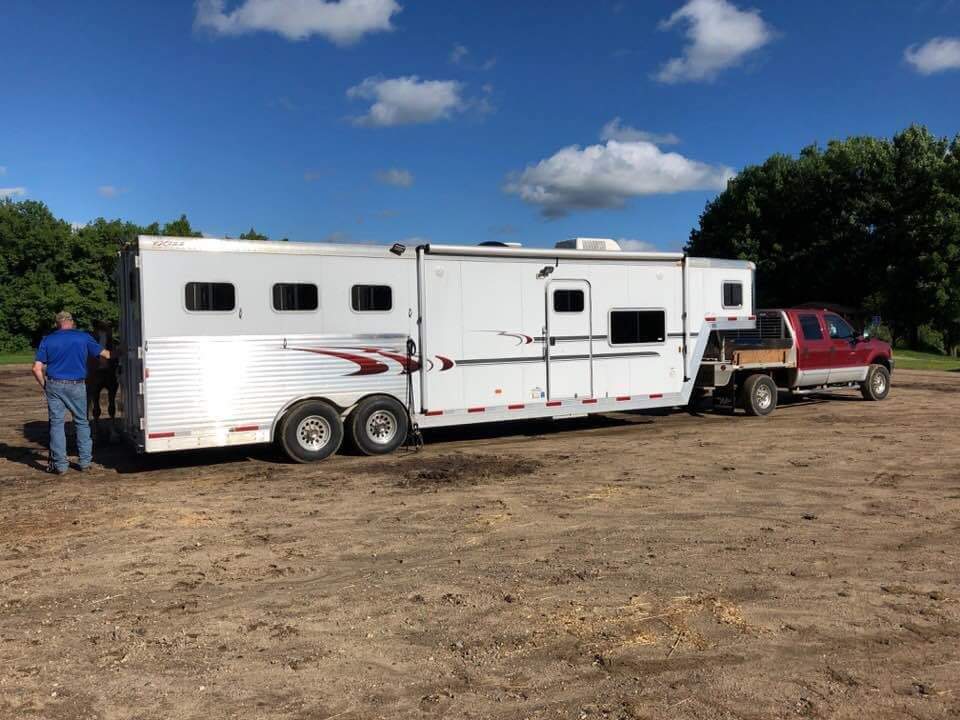

I can share this: After transmission and/or tuning upgrades, I've never needed a 6.0 transmission cooler. That's not to say it's not needed on the stock configuration when towing. Now... if you tow heavy in town (stop and go at low speeds), you need every bit of help you can get your hands on to keep things cool (like the transmission fluid heat exchange in the radiator).
Here's an EO4D (weaker than the 4R100) in front of a healthy load. Note the engine in the bed of the wrecked pickup - that's a 7.3L (and stand... with all the trimmings in boxes in the bed), to go along with the fully-populated engine compartment. There are also 6 spare tires under the truck at 75 pounds each. 13.1K, and he drove over some treacherous grades to reach his home 700 miles away. No 6.0 cooler, but good tuning.
